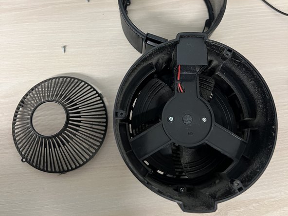

    • Flip the device so that it is no longer upside down.
    • If the top cover is stuck, grab onto the base and push the cover out with your thumb.

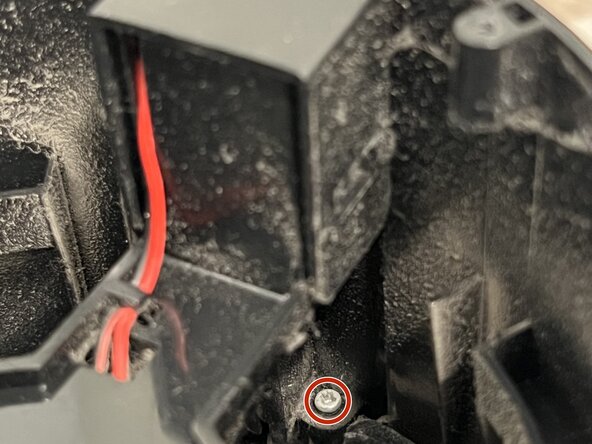

  8. KATCHY Insect Trap Disassembly and Clean: crwdns2935265:08crwdnd2935265:01crwdnd2935265:01crwdne2935265:0
    • Be careful not to damage the wire connecting it to the base. They should be connected still.

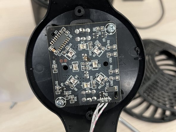

  9. KATCHY Insect Trap Disassembly and Clean: crwdns2935265:09crwdnd2935265:01crwdnd2935265:02crwdne2935265:0 KATCHY Insect Trap Disassembly and Clean: crwdns2935265:09crwdnd2935265:02crwdnd2935265:02crwdne2935265:0
    • (Extra) Two screws are protecting the circuit board if you want to do something with it.

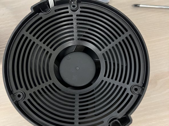

  10. KATCHY Insect Trap Disassembly and Clean: crwdns2935265:010crwdnd2935265:01crwdnd2935265:01crwdne2935265:0
    • Double-check that the fan has no dust to ensure the motor will run more efficiently with less dust.
