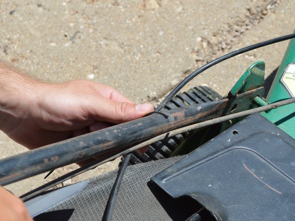

      • Locate the throttle assembly on your mower on the right side of the push bar.
    2. K-Gro PowerPro Lawnmower Drive Cable Replacement Guide: crwdns2935265:02crwdnd2935265:01crwdnd2935265:03crwdne2935265:0 K-Gro PowerPro Lawnmower Drive Cable Replacement Guide: crwdns2935265:02crwdnd2935265:02crwdnd2935265:03crwdne2935265:0 K-Gro PowerPro Lawnmower Drive Cable Replacement Guide: crwdns2935265:02crwdnd2935265:03crwdnd2935265:03crwdne2935265:0
      • The throttle assembly is attached to the push bar with a 7/16" bolt and nut.
      • Using a 3/8" drive rachet wrench with a 7/16" socket and a 7/16" combination wrench, remove the nut.
      • Pull the plastic cable connection away from the framework.

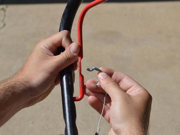

    3. K-Gro PowerPro Lawnmower Drive Cable Replacement Guide: crwdns2935265:03crwdnd2935265:01crwdnd2935265:02crwdne2935265:0 K-Gro PowerPro Lawnmower Drive Cable Replacement Guide: crwdns2935265:03crwdnd2935265:02crwdnd2935265:02crwdne2935265:0
      • After disconnecting the plastic connector plate from the main body, you can see that the cable is hooked and looped around the orange handle.
      • Pull the cable towards the handle to allow the wire to become loose. This will give you enough room to remove the hook.

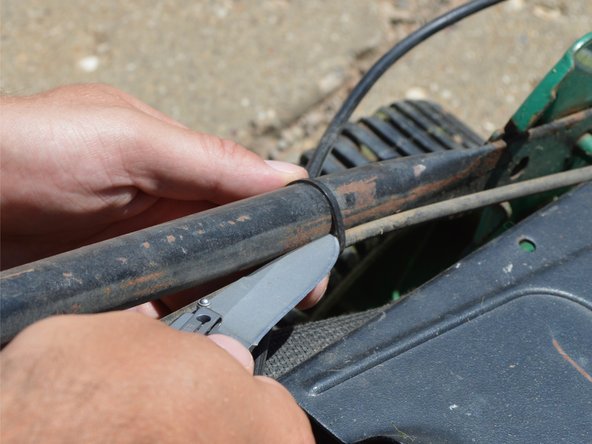

    4. K-Gro PowerPro Lawnmower Drive Cable Replacement Guide: crwdns2935265:04crwdnd2935265:01crwdnd2935265:03crwdne2935265:0 K-Gro PowerPro Lawnmower Drive Cable Replacement Guide: crwdns2935265:04crwdnd2935265:02crwdnd2935265:03crwdne2935265:0 K-Gro PowerPro Lawnmower Drive Cable Replacement Guide: crwdns2935265:04crwdnd2935265:03crwdnd2935265:03crwdne2935265:0
      • Following the cable down to the engine, you see that a zip tie holds the cable to the main handle.
      • Use a box cutter, sharp pocket knife, or cutting pliers to cut the zip tie.
      • Use gloves to prevent cutting yourself.

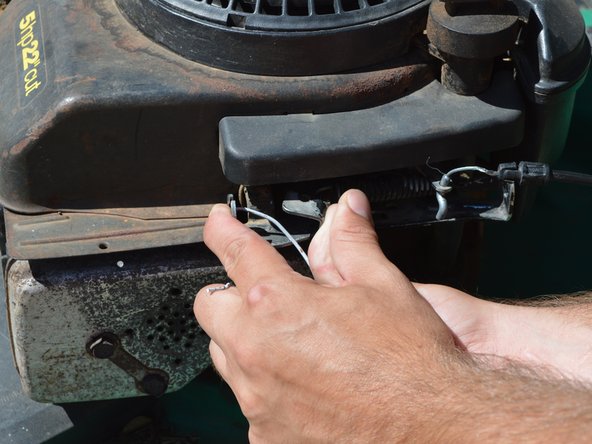

    5. K-Gro PowerPro Lawnmower Drive Cable Replacement Guide: crwdns2935265:05crwdnd2935265:01crwdnd2935265:02crwdne2935265:0 K-Gro PowerPro Lawnmower Drive Cable Replacement Guide: crwdns2935265:05crwdnd2935265:02crwdnd2935265:02crwdne2935265:0

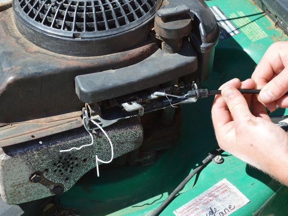

      • Locate the plastic fitting hooked to the steel housing of the engine.
      • To the left of the fitting, you will see a steel sliding mechanism connected by a spring.
      • Squeeze the mechanism together to allow for slack in the cable wire.
      • You might need to use pliers or clamps in order to squeeze the plates together.

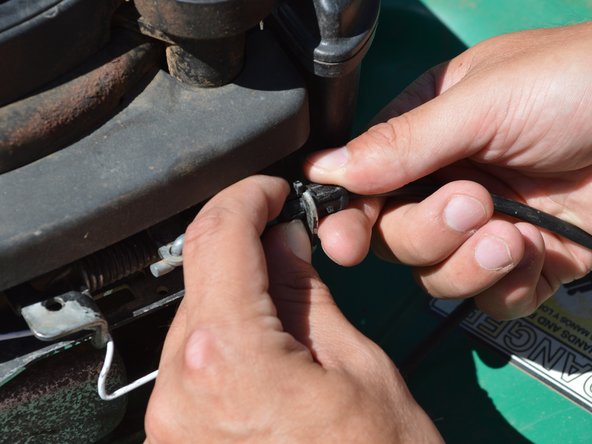

    6. K-Gro PowerPro Lawnmower Drive Cable Replacement Guide: crwdns2935265:06crwdnd2935265:01crwdnd2935265:03crwdne2935265:0 K-Gro PowerPro Lawnmower Drive Cable Replacement Guide: crwdns2935265:06crwdnd2935265:02crwdnd2935265:03crwdne2935265:0 K-Gro PowerPro Lawnmower Drive Cable Replacement Guide: crwdns2935265:06crwdnd2935265:03crwdnd2935265:03crwdne2935265:0
      • On close inspection of the plastic fitting, you can see that there are two "wings" that can be pinched together.
      • With the sliding mechanism squeezed and the wire slack, pinch the plastic wings together and push the fitting to the right out of the hole in the housing.
      • The loose wire can then be slid up through the groove in the steel.

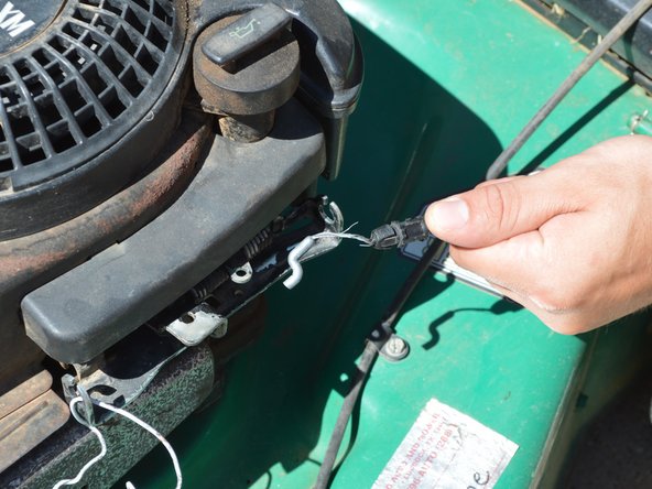

    7. K-Gro PowerPro Lawnmower Drive Cable Replacement Guide: crwdns2935265:07crwdnd2935265:01crwdnd2935265:02crwdne2935265:0 K-Gro PowerPro Lawnmower Drive Cable Replacement Guide: crwdns2935265:07crwdnd2935265:02crwdnd2935265:02crwdne2935265:0
      • You can see that the only thing still holding the cable on is a hook attached to a spring loaded lever.
      • Remove the hook.
