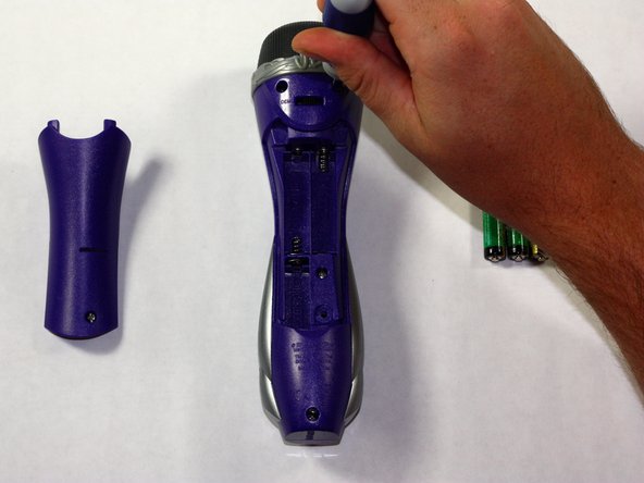

    • Remove the back panel of the device by unscrewing the single #8 11.6 mm Flathead screw on the back of the device.
  2. Justin Bieber Concert Microphone Speaker Replacement, Removing batteries: crwdns2935265:02crwdnd2935265:01crwdnd2935265:01crwdne2935265:0
    • Remove the 3 AAA batteries from the device.
  3. Justin Bieber Concert Microphone Speaker Replacement, Removing back half of device: crwdns2935265:03crwdnd2935265:01crwdnd2935265:02crwdne2935265:0 Justin Bieber Concert Microphone Speaker Replacement, Removing back half of device: crwdns2935265:03crwdnd2935265:02crwdnd2935265:02crwdne2935265:0
    • Unscrew the other 4, #8 11.5 mm Phillips head screws to remove the entire back half of the device.
    • Pull apart the device once screws are loose, splitting the device in half.
