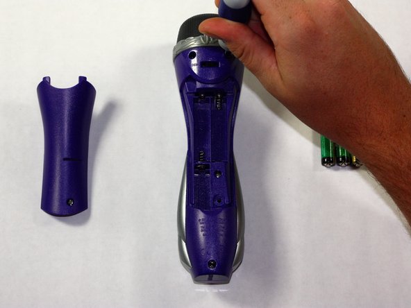

    • Remove the back panel of the device by unscrewing the single #8 11.6 mm Flathead screw on the back of the device.
  2. Justin Bieber Concert Microphone Printed Circuit Board (PCB) Replacement, Removing batteries: crwdns2935265:02crwdnd2935265:01crwdnd2935265:01crwdne2935265:0
    • Remove the 3 AAA batteries from the device.
  3. Justin Bieber Concert Microphone Printed Circuit Board (PCB) Replacement, Removing back half of device: crwdns2935265:03crwdnd2935265:01crwdnd2935265:02crwdne2935265:0 Justin Bieber Concert Microphone Printed Circuit Board (PCB) Replacement, Removing back half of device: crwdns2935265:03crwdnd2935265:02crwdnd2935265:02crwdne2935265:0
    • Unscrew the other 4, #8 11.6 mm Phillips Head screws to remove the entire back half of the device.
    • Pull apart the device once screws are loose, splitting the device in half.

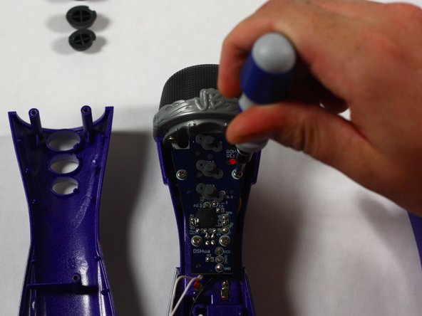

  5. Justin Bieber Concert Microphone Printed Circuit Board (PCB) Replacement, Inspecting PCB: crwdns2935265:05crwdnd2935265:01crwdnd2935265:01crwdne2935265:0
    • Inspect the printed circuit board for any breaks or cracks.
  6. Justin Bieber Concert Microphone Printed Circuit Board (PCB) Replacement, Removing PCB: crwdns2935265:06crwdnd2935265:01crwdnd2935265:02crwdne2935265:0 Justin Bieber Concert Microphone Printed Circuit Board (PCB) Replacement, Removing PCB: crwdns2935265:06crwdnd2935265:02crwdnd2935265:02crwdne2935265:0
    • Remove the 2, #8 11.7 mm Phillips Head screws as well as the 2, #8 7.5 mm screws on the printed circuit board.

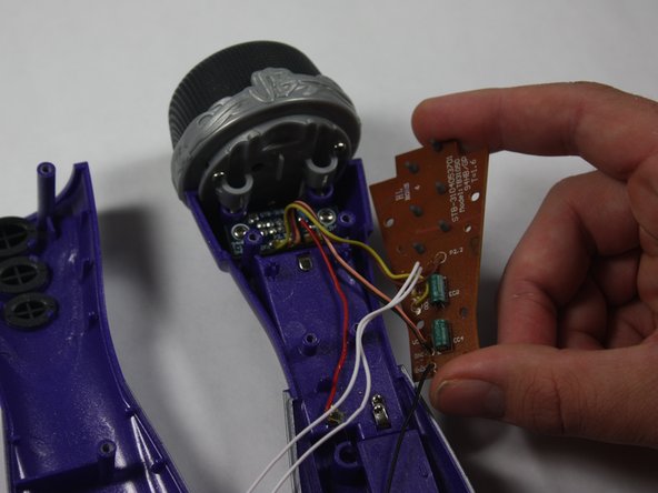

  7. Justin Bieber Concert Microphone Printed Circuit Board (PCB) Replacement, Replacing PCB: crwdns2935265:07crwdnd2935265:01crwdnd2935265:02crwdne2935265:0 Justin Bieber Concert Microphone Printed Circuit Board (PCB) Replacement, Replacing PCB: crwdns2935265:07crwdnd2935265:02crwdnd2935265:02crwdne2935265:0
    • Disconnect all wires from the PCB
    • Remove the damaged PCB from the microphone
    • Place new PCB in the Justin Bieber Concert Microphone.
    • Connect all the wires to the new PCB using this soldering guide.
