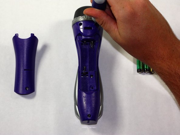

    • Remove the back panel of the device by unscrewing the single #8 11.6 mm Flathead screw on the back of the device.
  2. Justin Bieber Concert Microphone On/Off Switch Replacement, Removing batteries: crwdns2935265:02crwdnd2935265:01crwdnd2935265:01crwdne2935265:0
    • Remove the 3 AAA batteries from the device.

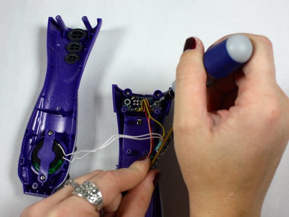

  3. Justin Bieber Concert Microphone On/Off Switch Replacement, Removing back half of device: crwdns2935265:03crwdnd2935265:01crwdnd2935265:02crwdne2935265:0 Justin Bieber Concert Microphone On/Off Switch Replacement, Removing back half of device: crwdns2935265:03crwdnd2935265:02crwdnd2935265:02crwdne2935265:0
    • Unscrew the other 4, #8 11.6 mm Phillips Head screws to remove the entire back half of the device.
    • Pull apart the device once screws are loose, splitting the device in half.
  4. Justin Bieber Concert Microphone On/Off Switch Replacement, Positioning device: crwdns2935265:04crwdnd2935265:01crwdnd2935265:01crwdne2935265:0
    • Keeping all wires connected to their attachments, place the front half of the device face down.

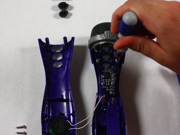

  5. Justin Bieber Concert Microphone On/Off Switch Replacement, Removing PCB: crwdns2935265:05crwdnd2935265:01crwdnd2935265:02crwdne2935265:0 Justin Bieber Concert Microphone On/Off Switch Replacement, Removing PCB: crwdns2935265:05crwdnd2935265:02crwdnd2935265:02crwdne2935265:0
    • Remove the 2, #8 11.7 mm Phillips Head screws as well as the 2, #8 7.5 mm screws on the printed circuit board.
  6. Justin Bieber Concert Microphone On/Off Switch Replacement, Removing on/off switch: crwdns2935265:06crwdnd2935265:01crwdnd2935265:02crwdne2935265:0 Justin Bieber Concert Microphone On/Off Switch Replacement, Removing on/off switch: crwdns2935265:06crwdnd2935265:02crwdnd2935265:02crwdne2935265:0
    • Remove the 2, #8 11.7 mm Phillips Head screws on the On/Off Switch Board

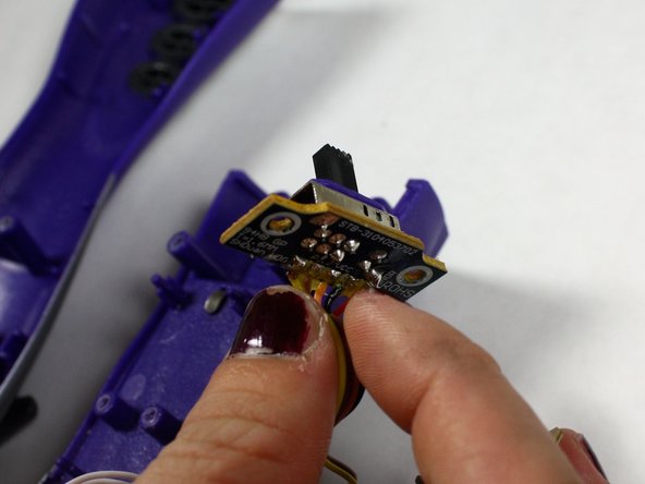

  7. Justin Bieber Concert Microphone On/Off Switch Replacement, Replacing on/off switch: crwdns2935265:07crwdnd2935265:01crwdnd2935265:02crwdne2935265:0 Justin Bieber Concert Microphone On/Off Switch Replacement, Replacing on/off switch: crwdns2935265:07crwdnd2935265:02crwdnd2935265:02crwdne2935265:0
    • Remove On/Off Switch Board from its holding and detach the wires.
    • Replace the On/Off Switch Board with a new one and reattach the wires using this soldering guide
