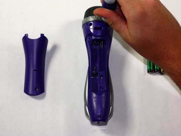

    • Remove the back panel of the device by unscrewing the single #8 11.6 mm Flathead screw on the back of the device.
  2. Justin Bieber Concert Microphone Button Replacement, Removing batteries: crwdns2935265:02crwdnd2935265:01crwdnd2935265:01crwdne2935265:0
    • Remove the 3 AAA batteries from the device.
  3. Justin Bieber Concert Microphone Button Replacement, Removing back half of device: crwdns2935265:03crwdnd2935265:01crwdnd2935265:02crwdne2935265:0 Justin Bieber Concert Microphone Button Replacement, Removing back half of device: crwdns2935265:03crwdnd2935265:02crwdnd2935265:02crwdne2935265:0
    • Unscrew the other 4, #8 11.6 mm Phillips Head screws to remove the entire back half of the device.
    • Pull apart the device once screws are loose, splitting the device in half.

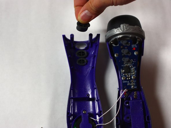

  4. Justin Bieber Concert Microphone Button Replacement, Positioning device: crwdns2935265:04crwdnd2935265:01crwdnd2935265:01crwdne2935265:0
    • Keeping all wires connected to their attachments, place the front half of the device face down.
  5. Justin Bieber Concert Microphone Button Replacement, Removing buttons: crwdns2935265:05crwdnd2935265:01crwdnd2935265:02crwdne2935265:0 Justin Bieber Concert Microphone Button Replacement, Removing buttons: crwdns2935265:05crwdnd2935265:02crwdnd2935265:02crwdne2935265:0
    • Remove the buttons by pushing them out from the front of the device. Clean or replace them as needed and place them back into the appropriate slots.
