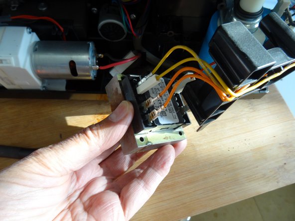

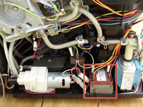

  9. Jura Z models transformer replacement, Transformer: crwdns2935265:09crwdnd2935265:01crwdnd2935265:02crwdne2935265:0 Jura Z models transformer replacement, Transformer: crwdns2935265:09crwdnd2935265:02crwdnd2935265:02crwdne2935265:0
    • The transformer is located on the side between the ceramic valve and the pump. Depending on the model, a bracket may need to be removed.
    • The pictures depict different models.

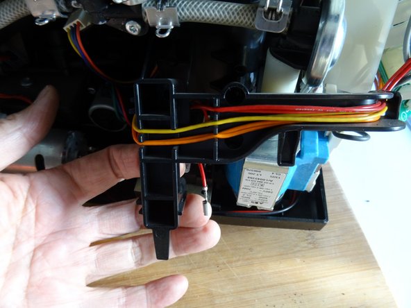

  10. Jura Z models transformer replacement: crwdns2935265:010crwdnd2935265:01crwdnd2935265:03crwdne2935265:0 Jura Z models transformer replacement: crwdns2935265:010crwdnd2935265:02crwdnd2935265:03crwdne2935265:0 Jura Z models transformer replacement: crwdns2935265:010crwdnd2935265:03crwdnd2935265:03crwdne2935265:0
    • Unscrew the two low-lying Torx T15 screws from the bracket and remove the bracket.
    • Lift the transformer out.
  11. Jura Z models transformer replacement: crwdns2935265:011crwdnd2935265:01crwdnd2935265:01crwdne2935265:0
    • The transformers are the same in practically all Jura devices.
    • Disconnect the two red (230 V), the two orange flat connectors (15 V), and two yellow ones (9 V) from the transformer.
    • To test the transformer, start by measuring the resistances: the 15 V and 9 V terminals (secondary) should read about 1 Ohm, and the 230 V terminals (primary) should read approximately 100 Ohms.
    • You can also apply an AC voltage of about 20 V to the 230 V (primary) side. You then should measure approximately 1.4 V on the 15 V (secondary) side and around 0.8 V on the 9 V (secondary) side. Never interchange the primary and secondary sides, as it could result in dangerously high voltages.
