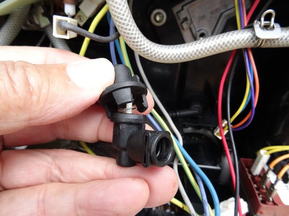

  9. Jura Z Model Exhaust valve repair, Repair outlet valves: crwdns2935265:09crwdnd2935265:01crwdnd2935265:02crwdne2935265:0 Jura Z Model Exhaust valve repair, Repair outlet valves: crwdns2935265:09crwdnd2935265:02crwdnd2935265:02crwdne2935265:0
    • Pull out the clamp on the lower outlet valve.
    • Carefully slide the lower outlet valve to the left so that the pressure hose comes out. Watch out for the O-ring. It will either get stuck in the valve or on the end of the hose. Replace it with a new one when reassembling.
    • Lift out the valve. The two hoses on the left can stay on.

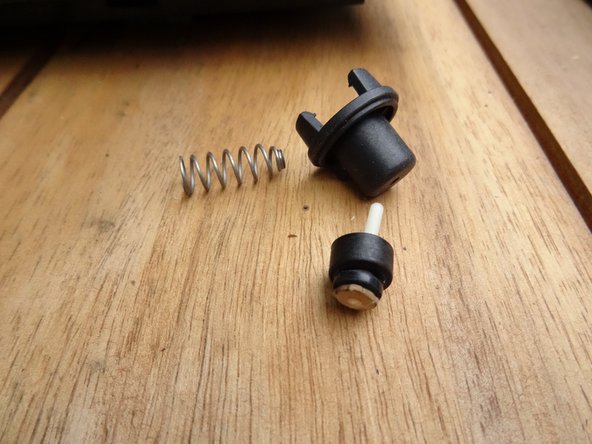

    • The cover on top of the valve is held by three detents. Gently release the three detents with the flat end of a spatula and lift the cover straight up.
    • Carefully lift out the spring and valve stem. Pay attention to the sequence for later reassembly.

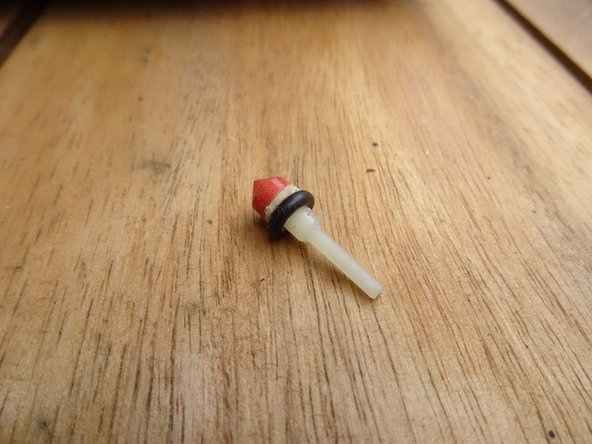

  10. Jura Z Model Exhaust valve repair: crwdns2935265:010crwdnd2935265:01crwdnd2935265:03crwdne2935265:0 Jura Z Model Exhaust valve repair: crwdns2935265:010crwdnd2935265:02crwdnd2935265:03crwdne2935265:0 Jura Z Model Exhaust valve repair: crwdns2935265:010crwdnd2935265:03crwdnd2935265:03crwdne2935265:0
    • Open the cover on the upper outlet valve in the same way.
    • Gently lift out the valve plunger.
    • Both valve plungers on this unit were broken. They were replaced with new ones. The plastic model is shown here, but a metal valve plunger will never break again.
    • If the plunger is still good, all you need to do is install new gaskets. Coat the seals thinly with food-grade silicone grease.
