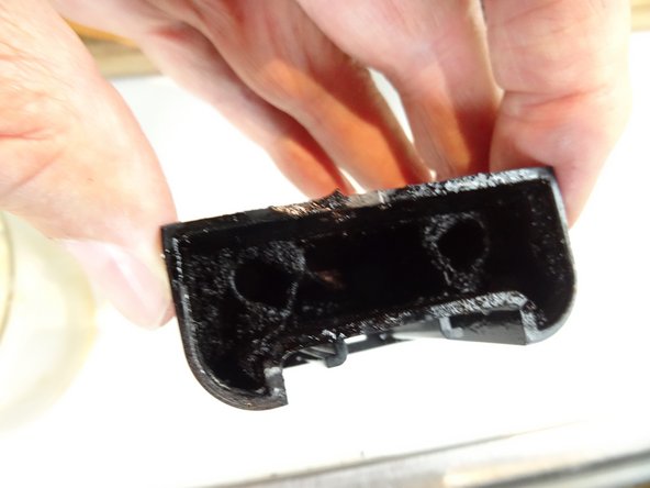

  3. Jura Z Model Coffee Spout Cleaning: crwdns2935265:03crwdnd2935265:01crwdnd2935265:03crwdne2935265:0 Jura Z Model Coffee Spout Cleaning: crwdns2935265:03crwdnd2935265:02crwdnd2935265:03crwdne2935265:0 Jura Z Model Coffee Spout Cleaning: crwdns2935265:03crwdnd2935265:03crwdnd2935265:03crwdne2935265:0
    • Insert a flat lever tool into the gap at the outlet nozzles.
    • Carefully lift the outlet nozzles out downwards.
    • It may jam a little bit.
    • As you can see, the nozzles on this machine were very dirty, the coffee came out everywhere. Clean everything very well.
Work through the steps in reverse order to reassemble your device.
