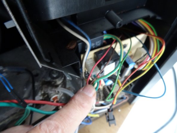

  17. Jura Impressa S Model Thermoblock Replacement: crwdns2935265:017crwdnd2935265:01crwdnd2935265:01crwdne2935265:0
    • Disconnect the cables from the water boiler.
    • If the two green-red wires are interfering, you can disconnect them at the connector on the motherboard.
    • Depending on the model, other connections may be present.

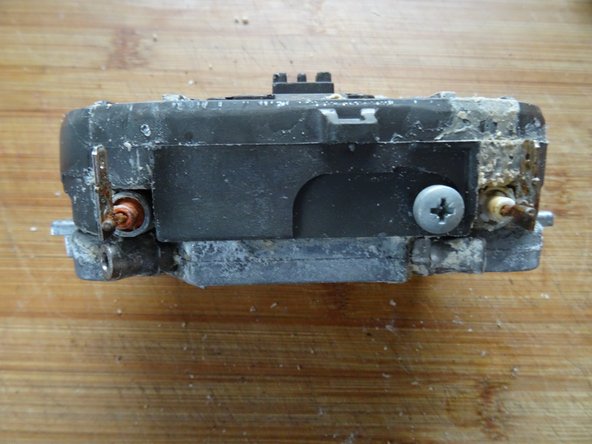

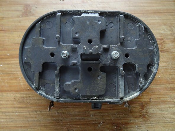

  22. Jura Impressa S Model Thermoblock Replacement: crwdns2935265:022crwdnd2935265:01crwdnd2935265:03crwdne2935265:0 Jura Impressa S Model Thermoblock Replacement: crwdns2935265:022crwdnd2935265:02crwdnd2935265:03crwdne2935265:0 Jura Impressa S Model Thermoblock Replacement: crwdns2935265:022crwdnd2935265:03crwdnd2935265:03crwdne2935265:0
    • The heaters are screwed tightly to the sides. Unscrew the three screws.
    • Lift out the two heaters. They are still connected to each other.
    • Loosen the Torx T20 screw on the thermal fuse of the thermoblock.
    • Take off the thermal fuse.
    • The two remaining heaters should be separate.
  23. Jura Impressa S Model Thermoblock Replacement: crwdns2935265:023crwdnd2935265:01crwdnd2935265:03crwdne2935265:0 Jura Impressa S Model Thermoblock Replacement: crwdns2935265:023crwdnd2935265:02crwdnd2935265:03crwdne2935265:0 Jura Impressa S Model Thermoblock Replacement: crwdns2935265:023crwdnd2935265:03crwdnd2935265:03crwdne2935265:0
    • Here is the heavily calcified thermoblock from all sides. It was replaced with a new one.
    • If the screws can be loosened, you can also try if it can be resealed.
