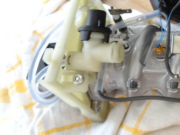

    • The outlet valve is located in the hot water pipe near the heater. In this model, it is screwed to the carriage for the heating cartridge.
    • Here the valve body is white. It can also be black.
    • t is easier if you pull the carriage out a little after the detents are released. However, this is not absolutely necessary.
    • The black cap on the valve is fixed with three detents. Loosen them carefully with a spudgerl.
    • Gently lift the cap off. Pay attention to the order of the spring, pressure plate and plunger.
    • In the second picture, the heater cartridge has been removed for clarity and the pressure hoses are detached, so the valve is easy to see. However, this is not a necessary step.

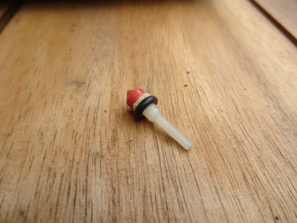

    • On this valve, the plunger was broken and had to be replaced with a new one. The plastic model is shown here, but a metal valve plunger would be better as it would not break again.
    • If the stamp is still good, it is sufficient to install new seals. Coat the seals thinly with food-grade silicone grease.
