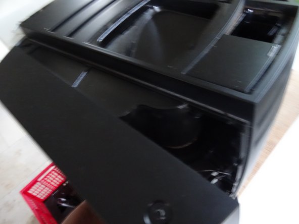

    • Never forget: disconnect the power plug!
    • Remove all attachments: Coffee ground container, trester drawer, water tank and the coffee beans.
    • Pull off the flap above the water tank to the rear.

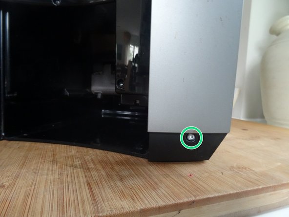

    • The side panel on the water tank side is still attached with two Torx T15 screws. Unscrew them.
    • The side panel with the switch is fixed at the bottom front with one Torx T15 screw. Unscrew it.

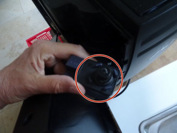

    • Push the two side panels back a bit and pull them out at the bottom, then you can remove them. Do not remove the side panel with the power switch completely yet.
    • Turn the power switch a little clockwise and remove it. Place the side panel aside
    • Lift the side panel on the water tank slightly upwards and pull it out at the bottom edge. You can then remove it and put it to one side.
    • It is a bit tricky to reinstall the side panel. Many bayonets have to be hooked in at the same time. It's easier if you push the water tank seal carrier up a little while you slide the side panel in. Then let it slide down.

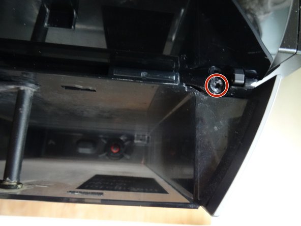

    • Unscrew the Torx T15 screw on the bean hopper.
    • Unscrew the last screw that holds the upper part at the front.
    • Now you can remove the upper cover, it binds a bit.
    • For most repairs, this is enough, you may also have to unscrew the back cover and remove it.
