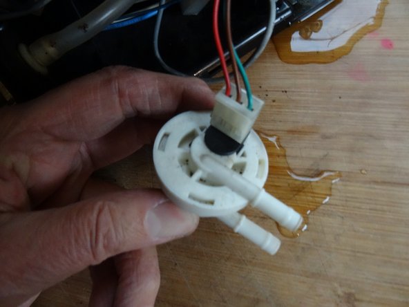

    • The flowmeter is the white round box in the back of the unit. It has to be removed for revision, but that won’t be difficult.
    • Slide the two silicone tubes off the flowmeter.

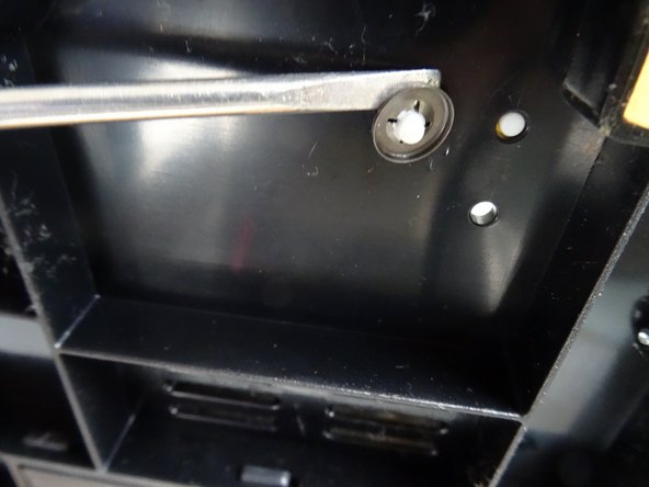

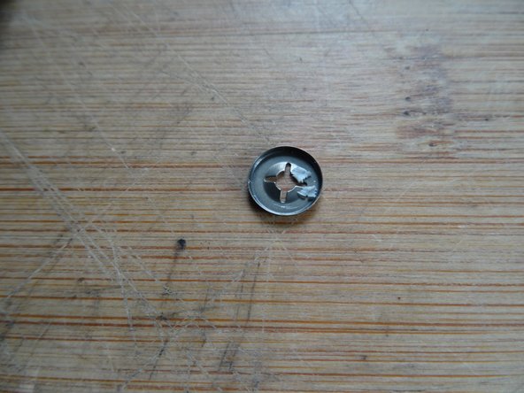

    • Tilt the unit to the side so that you can reach the base plate. The flowmeter has a pin on the bottom that is attached to the base plate with a clamping ring.
    • A second pin fixes the position of the flowmeter.
    • Gently prise off the clamping ring with a flathead screwdriver or spudger. When levering, start at different points.

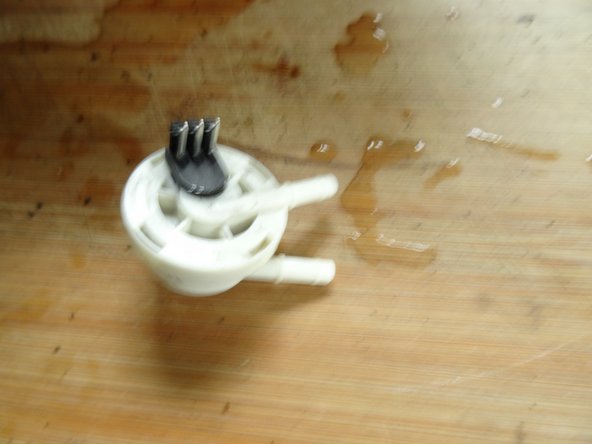

    • Lift out the flowmeter. The cables can also remain plugged in.

    • Blow into the flowmeter at the lower nozzle. Air should flow easily and you should hear the turbine whirring.
    • The upper half of the flowmeter is locked in place with a bayonet catch. Turn the upper part slightly counterclockwise.
    • Lift off the upper half. Watch out for the sealing ring. The turbine can be lifted out easily.
    • Now you can clean and decalcify everything well. In particular, clean the inlet spout, e.g. with a needle or other suitable thin object as the opening is quite narrow.
    • If the turbine does not run easily now, the flowmeter must be replaced. The sensor itself may also be defective.
