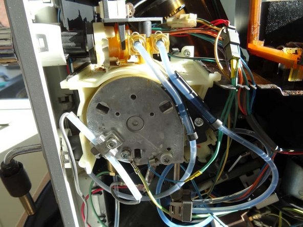

    • The block is marked red here.
    • Older models have a completely differently shaped thermoblock. (Pictures 3). The guide for this you can find here.
    • There are three connections for water or steam.
    • Three cable feeders.
    • A thermocouple.
  5. Jura Heater Replacement, Release connections: crwdns2935265:05crwdnd2935265:01crwdnd2935265:03crwdne2935265:0 Jura Heater Replacement, Release connections: crwdns2935265:05crwdnd2935265:02crwdnd2935265:03crwdne2935265:0 Jura Heater Replacement, Release connections: crwdns2935265:05crwdnd2935265:03crwdnd2935265:03crwdne2935265:0
    • First, pull the clips on the tubing connectors, then pull out the tubing.
    • Then remove the power cables: A gray cable leading to the thermal fuse, a blue one directly from the heater (can also be pulled later) and the green-yellow protective cable is unscrewed.
    • Two small blue cables lead to the temperature sensor, it is unscrewed.
    • The hexagon screw in the middle can be loosened.
    • Unscrew the tube holder, then the block is free.

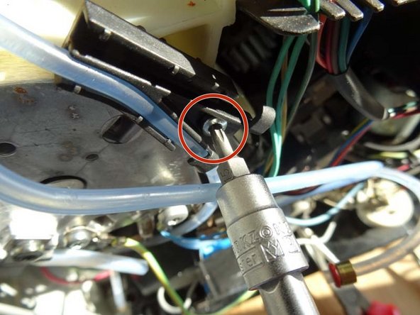

    • For mounting, the light carrier must be pulled out by loosening the marked screw.

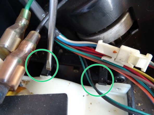

    • It is attached with two hooks, you can lift them with a screwdriver.

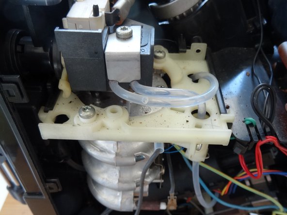

    • The steam valve is actuated by a plastic disc with a cross-shaped cut. To loosen, you have to pull the whole front wall carefully outwards, then you can pull out the entire unit.
  8. Jura Heater Replacement, Assembly of the new block 2: crwdns2935265:08crwdnd2935265:01crwdnd2935265:01crwdne2935265:0
    • Now you can see why all this was necessary: on the back of the carrier is a recess. Inside is loosely the lock nut to the big screw with which the block is attached.
    • Thus, first the new block is screwed into the carrier.
    • And now go through all the steps again in reverse order!
