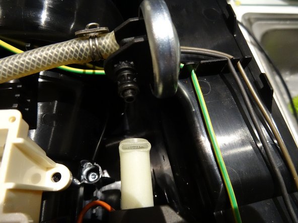

  13. Jura ENA micro 9 water tank gasket replacement, Water tank gasket: crwdns2935265:013crwdnd2935265:01crwdnd2935265:01crwdne2935265:0
    • The first picture shows the already removed holder and the seal. The next steps will show you how to get it out.
    • The pump must be partially removed to get to the holder. Luckily this is quite simple.

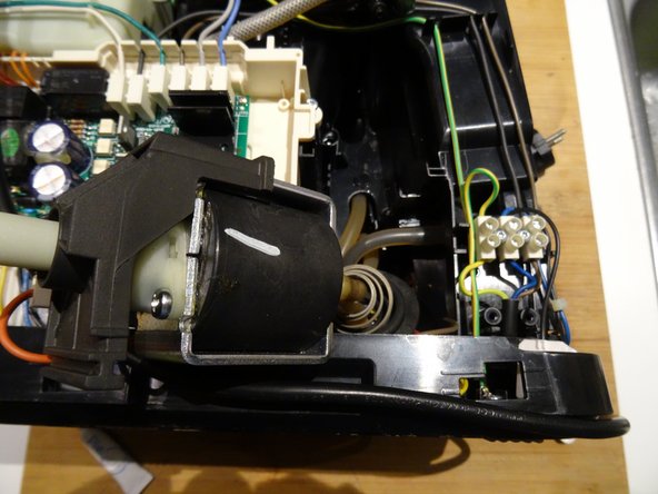

  14. Jura ENA micro 9 water tank gasket replacement: crwdns2935265:014crwdnd2935265:01crwdnd2935265:03crwdne2935265:0 Jura ENA micro 9 water tank gasket replacement: crwdns2935265:014crwdnd2935265:02crwdnd2935265:03crwdne2935265:0 Jura ENA micro 9 water tank gasket replacement: crwdns2935265:014crwdnd2935265:03crwdnd2935265:03crwdne2935265:0
    • Remove the three Torx T15 screws that secure the electronics box.
    • Lift the box a little to the side so that the pump can be removed. The connection cables can all remain connected.
    • Pull out the metal clamp at the upper pump outlet.
    • Pull out the diaphragm damper above the pump, the hose can remain connected. Pay attention to the gasket, it is best to replace it.
  15. Jura ENA micro 9 water tank gasket replacement: crwdns2935265:015crwdnd2935265:01crwdnd2935265:02crwdne2935265:0 Jura ENA micro 9 water tank gasket replacement: crwdns2935265:015crwdnd2935265:02crwdnd2935265:02crwdne2935265:0
    • Lift out the pump, the elastic suspension of the pump slides along in the rail.
    • Put the pump to the side, the cables and the lower hose can remain connected.

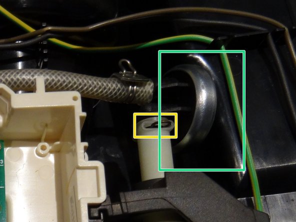

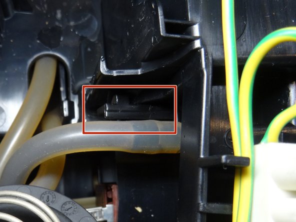

  16. Jura ENA micro 9 water tank gasket replacement: crwdns2935265:016crwdnd2935265:01crwdnd2935265:02crwdne2935265:0 Jura ENA micro 9 water tank gasket replacement: crwdns2935265:016crwdnd2935265:02crwdnd2935265:02crwdne2935265:0
    • Now you can clearly see how the silicone hose leads to the holder for the seal of the water connection. The holder must be turned about 45 degrees, then it can be taken out downwards. The rear end of the holder is secured by a detent and must be turned towards you.
    • Push the detent away a little and twist the holder.
  17. Jura ENA micro 9 water tank gasket replacement: crwdns2935265:017crwdnd2935265:01crwdnd2935265:01crwdne2935265:0
    • Now the seal can be easily replaced. Grease it with some food-safe silicone grease.
