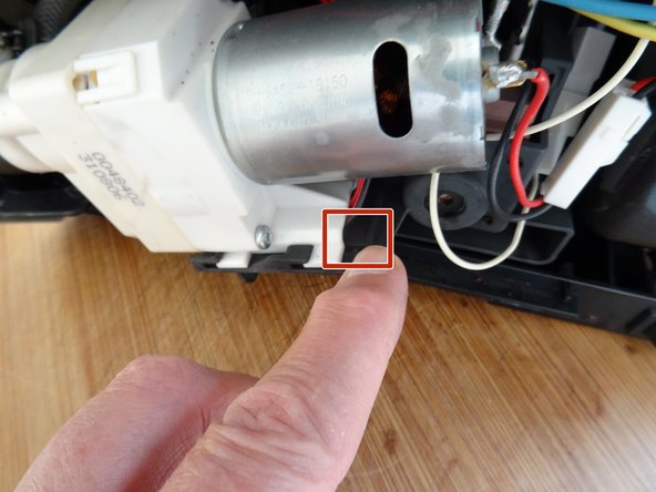

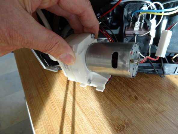

    • Find the ceramic valve at the bottom behind the right side panel It is slid onto a black plastic support plate and connected with two cable connections and three hoses.

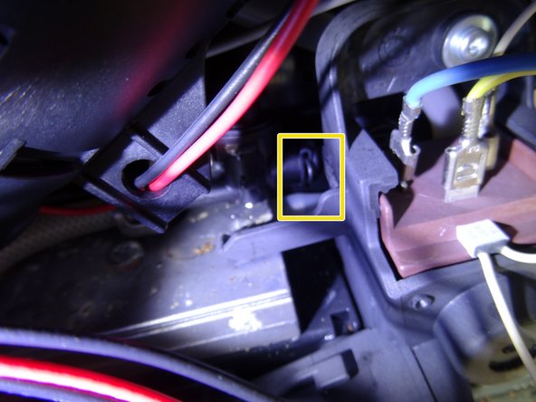

    • Using your finger press the black plastic detent down.
    • Push the ceramic valve upward to the right.
    • The valve may still be secured on the underside with a screw.
    • If you want to replace the valve, you have to disconnect all cables and hoses. If you are only removing the valve to access other components (outlet valve, heat exchanger), you do not need to disconnect the connections.

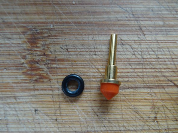

    • Push the valve to the left. There is an O-ring seal on the connection, do not lose it. If possible, replace it during reassembly. The two hoses can remain connected.
  13. Jura Capresso IMPRESSA J5 Outlet Valve Replacement/Service: crwdns2935265:013crwdnd2935265:01crwdnd2935265:03crwdne2935265:0 Jura Capresso IMPRESSA J5 Outlet Valve Replacement/Service: crwdns2935265:013crwdnd2935265:02crwdnd2935265:03crwdne2935265:0 Jura Capresso IMPRESSA J5 Outlet Valve Replacement/Service: crwdns2935265:013crwdnd2935265:03crwdnd2935265:03crwdne2935265:0
    • Three clips hold the black cap on top of the valve. Using a flathead screwdriver carefully losen them and lift off the cap.
    • Take out the spring, the valve piston and the seals with the spring plate. Note their position for reassembly.
    • This valve had a broken piston and aged seal. They were replaced, the piston from the repair kit is now made from metal and will never break again.
