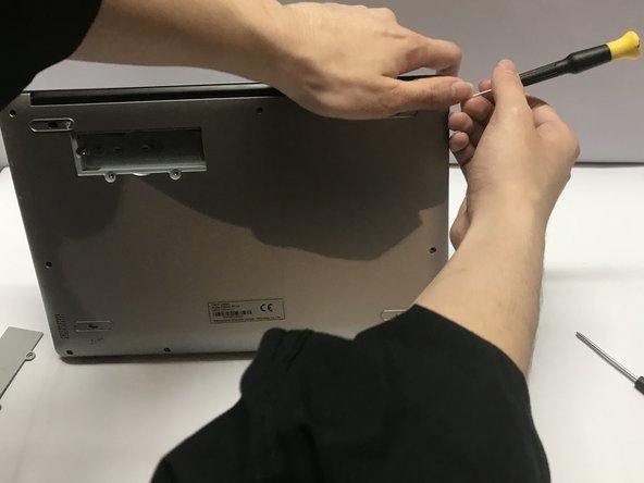

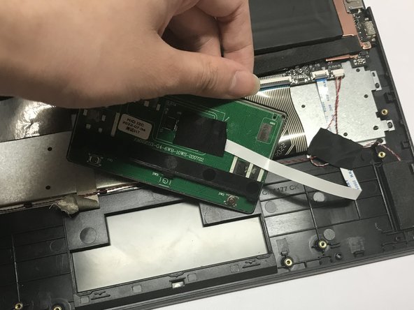

    • Place the laptop so the bottom is facing upwards.
    • Remove the two 8 mm screws on the back of the laptop using a T3 Torx screwdriver.
    • Remove the three 5 mm screws on the back of the laptop using a T3 Torx screwdriver.
    • Remove the six 4 mm screws on the back of the laptop using a T3 Torx screwdriver.
    • Remove the single 3 mm base screw inside the battery case using a T3 Torx screwdriver.

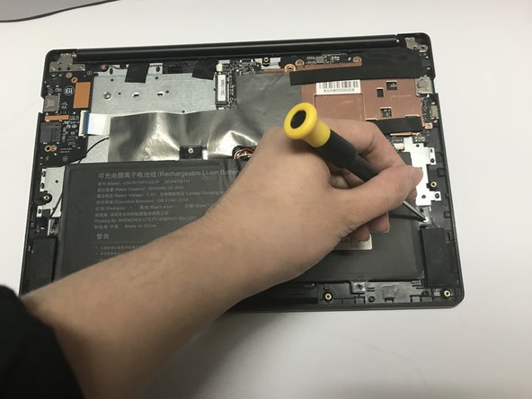

  2. Jumper EZbook S5 Touchpad Replacement: crwdns2935265:02crwdnd2935265:01crwdnd2935265:03crwdne2935265:0 Jumper EZbook S5 Touchpad Replacement: crwdns2935265:02crwdnd2935265:02crwdnd2935265:03crwdne2935265:0 Jumper EZbook S5 Touchpad Replacement: crwdns2935265:02crwdnd2935265:03crwdnd2935265:03crwdne2935265:0
    • Detach the battery case using the flat end of a spudger.

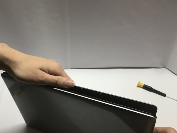

  3. Jumper EZbook S5 Touchpad Replacement: crwdns2935265:03crwdnd2935265:01crwdnd2935265:03crwdne2935265:0 Jumper EZbook S5 Touchpad Replacement: crwdns2935265:03crwdnd2935265:02crwdnd2935265:03crwdne2935265:0 Jumper EZbook S5 Touchpad Replacement: crwdns2935265:03crwdnd2935265:03crwdnd2935265:03crwdne2935265:0
    • Pry apart the bottom cover of the laptop using the flat end of a spudger.

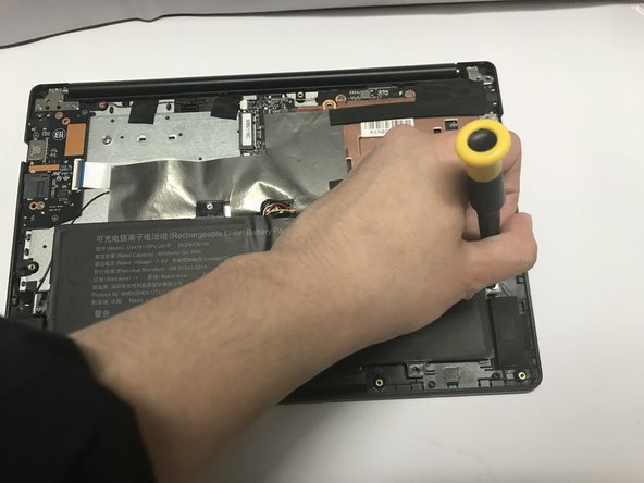

  4. Jumper EZbook S5 Touchpad Replacement: crwdns2935265:04crwdnd2935265:01crwdnd2935265:03crwdne2935265:0 Jumper EZbook S5 Touchpad Replacement: crwdns2935265:04crwdnd2935265:02crwdnd2935265:03crwdne2935265:0 Jumper EZbook S5 Touchpad Replacement: crwdns2935265:04crwdnd2935265:03crwdnd2935265:03crwdne2935265:0
    • Remove the four 4 mm screws from the battery using a T3 Torx screwdriver.
  5. Jumper EZbook S5 Touchpad Replacement: crwdns2935265:05crwdnd2935265:01crwdnd2935265:03crwdne2935265:0 Jumper EZbook S5 Touchpad Replacement: crwdns2935265:05crwdnd2935265:02crwdnd2935265:03crwdne2935265:0 Jumper EZbook S5 Touchpad Replacement: crwdns2935265:05crwdnd2935265:03crwdnd2935265:03crwdne2935265:0
    • Flip the battery to the opposite side of the touchpad.

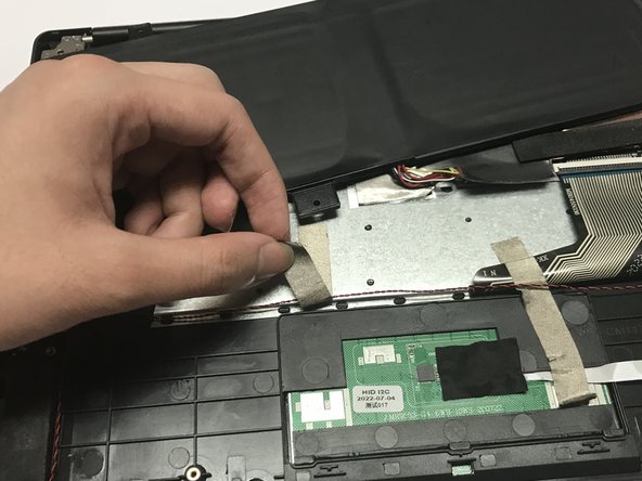

  6. Jumper EZbook S5 Touchpad Replacement: crwdns2935265:06crwdnd2935265:01crwdnd2935265:03crwdne2935265:0 Jumper EZbook S5 Touchpad Replacement: crwdns2935265:06crwdnd2935265:02crwdnd2935265:03crwdne2935265:0 Jumper EZbook S5 Touchpad Replacement: crwdns2935265:06crwdnd2935265:03crwdnd2935265:03crwdne2935265:0
    • Detach the tape on the left side of the touchpad shown in the first two images.
    • Use a heat gun or a hair dryer to melt the glue quickly.
  7. Jumper EZbook S5 Touchpad Replacement: crwdns2935265:07crwdnd2935265:01crwdnd2935265:03crwdne2935265:0 Jumper EZbook S5 Touchpad Replacement: crwdns2935265:07crwdnd2935265:02crwdnd2935265:03crwdne2935265:0 Jumper EZbook S5 Touchpad Replacement: crwdns2935265:07crwdnd2935265:03crwdnd2935265:03crwdne2935265:0
    • Detach the tape on the right side of the touchpad shown in all three images.
    • Use a hair dryer or a heat gun to soften the glue.

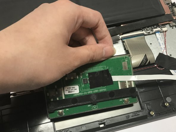

  8. Jumper EZbook S5 Touchpad Replacement: crwdns2935265:08crwdnd2935265:01crwdnd2935265:03crwdne2935265:0 Jumper EZbook S5 Touchpad Replacement: crwdns2935265:08crwdnd2935265:02crwdnd2935265:03crwdne2935265:0 Jumper EZbook S5 Touchpad Replacement: crwdns2935265:08crwdnd2935265:03crwdnd2935265:03crwdne2935265:0
    • Use a spudger to detach the touchpad from the top case.
    • The touchpad is attached to the top case with glue. Use a hair dryer or a heat gun to soften the glue.
    • Be patient. Step 8 can take up to 8 hours if you work by yourself.
    • Don't aim the heat gun or the hair dryer anywhere other than the top case.
  9. Jumper EZbook S5 Touchpad Replacement: crwdns2935265:09crwdnd2935265:01crwdnd2935265:03crwdne2935265:0 Jumper EZbook S5 Touchpad Replacement: crwdns2935265:09crwdnd2935265:02crwdnd2935265:03crwdne2935265:0 Jumper EZbook S5 Touchpad Replacement: crwdns2935265:09crwdnd2935265:03crwdnd2935265:03crwdne2935265:0
    • Lift the touchpad out of the case.
