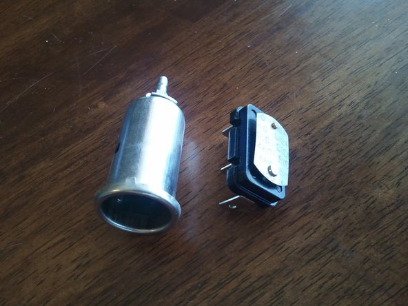

    • Both power inputs. AC/DC converter and DC 12V input.
    • The designers of this jump starter simply purchased an aftermarket AC/DC adapter and built it in.
    • The adapter has an input of 120V (typical outlet voltage) and an output of 15V (perfect for charging a 12V battery).
    • Left - DC Power Jack, Right - Thermal Relay for safety and protection

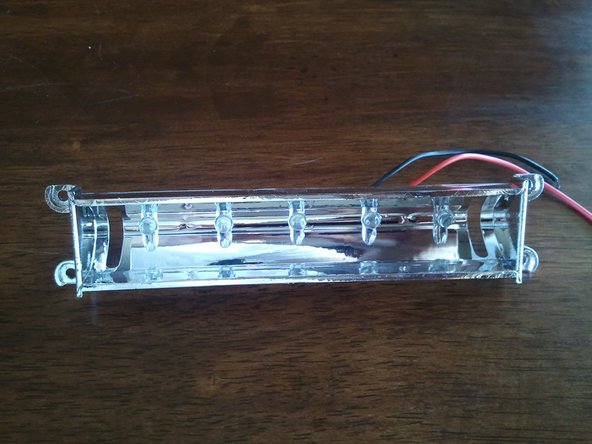

    • Light with 5 LED's

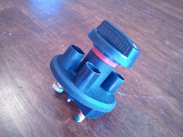

    • Big Switch to handle 12V
