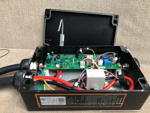

  3. JuiceBox EVSE Relay Replacement (UL/front LEDs version), Remove lid screws: crwdns2935265:04crwdnd2935265:01crwdnd2935265:01crwdne2935265:0
    • Place JuiceBox on a horizontal surface for easiest work.
    • Three different types of screws were used throughout the history of JuiceBox versions.
    • Philips #2 (silver screw)
    • 2.5mm hex (rusted black screw)
    • T20h security Torx (black screw)
    • If you have a 2.5mm hex screw, be extremely careful with it - they are easy to strip and tend to bind. Use exactly a clean 2.5mm hex bit - don't substitute a Torx or other size. Press down and turn counterclockwise strongly and carefully to unscrew.
    • Once 4 screws are removed, if your box has LEDs, pay close attention to the next step before proceeding.

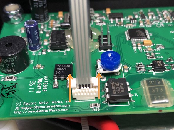

  4. JuiceBox EVSE Relay Replacement (UL/front LEDs version), Disconnect LED cable: crwdns2935265:05crwdnd2935265:01crwdnd2935265:03crwdne2935265:0 JuiceBox EVSE Relay Replacement (UL/front LEDs version), Disconnect LED cable: crwdns2935265:05crwdnd2935265:02crwdnd2935265:03crwdne2935265:0 JuiceBox EVSE Relay Replacement (UL/front LEDs version), Disconnect LED cable: crwdns2935265:05crwdnd2935265:03crwdnd2935265:03crwdne2935265:0
    • If your box has LEDs, slowly tilt the edge of the case away, revealing the ribbon cable connected to the board.
    • Lift the lock in the direction of the ribbon cable, and you should feel the ribbon cable release.
    • You may now remove the ribbon cable from the board, and place the lid aside.
    • During reassembly, note that the ribbon cable contacts should face opposite the lock slider (as in photo). To re-insert the ribbon cable, first release the lock, insert the cable, then press the lock back down to latch it in place.

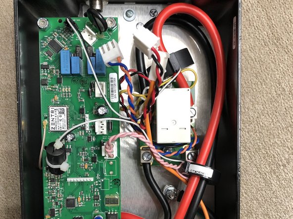

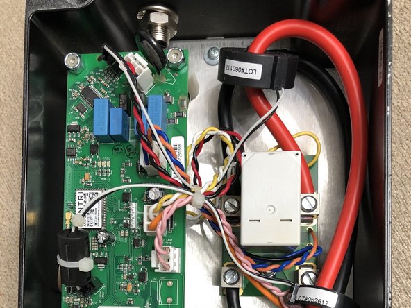

  5. JuiceBox EVSE Relay Replacement (UL/front LEDs version), Disconnect wire connectors from board: crwdns2935265:06crwdnd2935265:01crwdnd2935265:02crwdne2935265:0 JuiceBox EVSE Relay Replacement (UL/front LEDs version), Disconnect wire connectors from board: crwdns2935265:06crwdnd2935265:02crwdnd2935265:02crwdne2935265:0
    • Unplug 3 connectors from the main board
    • Red/black - AC input to board (logic/sensing supply)
    • Orange/blue - Relay sensing (detects if relay is closed)
    • Yellow/white/orange - Relay coil (12v) and EV pilot signal
    • Clip off the zip-tie holding the wires together in a bundle

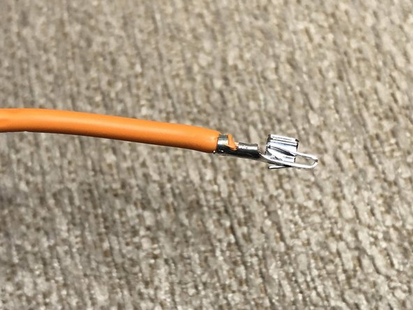

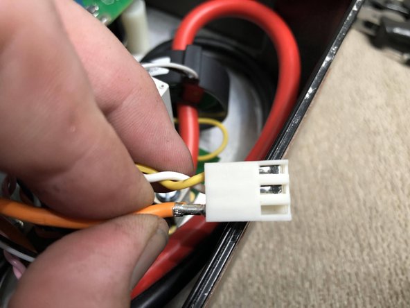

  6. JuiceBox EVSE Relay Replacement (UL/front LEDs version), Remove pilot wire: crwdns2935265:07crwdnd2935265:01crwdnd2935265:03crwdne2935265:0 JuiceBox EVSE Relay Replacement (UL/front LEDs version), Remove pilot wire: crwdns2935265:07crwdnd2935265:02crwdnd2935265:03crwdne2935265:0 JuiceBox EVSE Relay Replacement (UL/front LEDs version), Remove pilot wire: crwdns2935265:07crwdnd2935265:03crwdnd2935265:03crwdne2935265:0
    • Use a small flat blade screwdriver (1.5mm pictured) to press the release tine of the pilot wire, while pulling snugly on the wire to pull it out of the connector.
    • This can be a fiddly process. It does take a little force to pull the connector out, but not enough to rip it out of the crimp.
    • Feel free to go a bit ham with the screwdriver. You don't need this plastic housing - the new relay has a new housing. You do need the crimp though, so try to preserve it.
    • The pilot wire may be orange (most common) or blue (less common), but whether it's teal, auburn, heliotrope, gamboge, or rainbow colored - it's the position that matters :)
    • Once removed, find and flex the locking tab back into shape so it'll lock on the new connector.

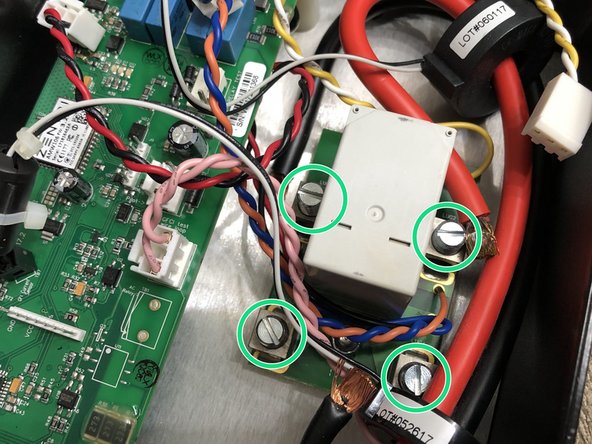

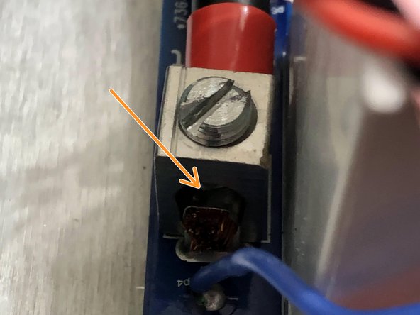

  7. JuiceBox EVSE Relay Replacement (UL/front LEDs version), Remove AC wires from screw terminals: crwdns2935265:08crwdnd2935265:01crwdnd2935265:03crwdne2935265:0 JuiceBox EVSE Relay Replacement (UL/front LEDs version), Remove AC wires from screw terminals: crwdns2935265:08crwdnd2935265:02crwdnd2935265:03crwdne2935265:0 JuiceBox EVSE Relay Replacement (UL/front LEDs version), Remove AC wires from screw terminals: crwdns2935265:08crwdnd2935265:03crwdnd2935265:03crwdne2935265:0
    • Observe and note the direction of the large current sensor around the red lead of the charging cable. The direction is programmed into the box at manufacture time - flipping it will cause your energy reporting to be ... backwards.
    • To simplify keeping this straight, you can simply slide the sensor back down the line (towards output cable gland) while working on the relay, without needing to remove the sensor.
    • Use a flat-head screwdriver (7mm used here) to unscrew the 4 screw terminals of the relay board.
    • Remove the 4 wires and bend aside.

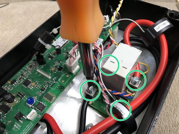

  8. JuiceBox EVSE Relay Replacement (UL/front LEDs version), Remove the relay: crwdns2935265:09crwdnd2935265:01crwdnd2935265:02crwdne2935265:0 JuiceBox EVSE Relay Replacement (UL/front LEDs version), Remove the relay: crwdns2935265:09crwdnd2935265:02crwdnd2935265:02crwdne2935265:0
    • Remove the two 11/32" hex nuts that secure the relay board to the chassis.
    • Lift the relay and board out of the chassis.

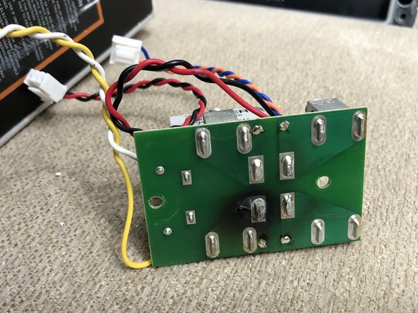

  9. JuiceBox EVSE Relay Replacement (UL/front LEDs version), Observe and correct red/black polarity: crwdns2935265:010crwdnd2935265:01crwdnd2935265:01crwdne2935265:0
    • It's been discovered that different ages of JuiceBoxes have the red/black pins in different positions (nearly 50/50%).
    • Using the same technique as removing the pilot wire in an earlier step, compare your new replacement relay and your original relay, and swap the red/black pins as needed.
    • The JuiceBox will work without doing this, but may report reverse energy. If you see erroneous energy reporting in the app (e.g. inverted power graphs, weird stats), flipping the red/black should fix it.

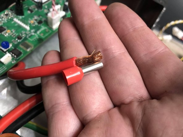

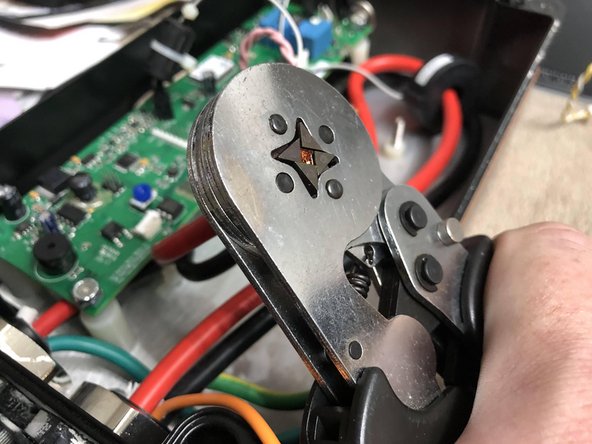

  10. JuiceBox EVSE Relay Replacement (UL/front LEDs version), (Optional) Crimp ferrules to wire ends: crwdns2935265:011crwdnd2935265:01crwdnd2935265:03crwdne2935265:0 JuiceBox EVSE Relay Replacement (UL/front LEDs version), (Optional) Crimp ferrules to wire ends: crwdns2935265:011crwdnd2935265:02crwdnd2935265:03crwdne2935265:0 JuiceBox EVSE Relay Replacement (UL/front LEDs version), (Optional) Crimp ferrules to wire ends: crwdns2935265:011crwdnd2935265:03crwdnd2935265:03crwdne2935265:0
    • Crimping ferrules onto the wire ends was an improvement added to later production JuiceBoxes. You can add this layer of protection yourself by crimping ferrules to the wire ends before installing a new relay.
    • Strip a bit more insulation off the wire strand, to allow the wire to fill the full ferrule.
    • Insert the ferrule on the wire end, while stuffing the wire insulation into the plastic collar so that the copper strands are just poking up to the end of the crimp.
    • Insert ferrule (now with wire) into the crimper (but don't crimp the plastic collar!), and squeeze to crimp - these crimpers are self-adjusting to wire size.
    • Repeat for all 4 wires.
