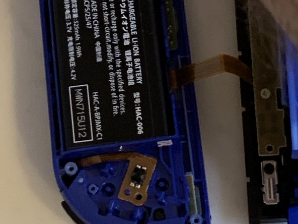

  4. Joy-Con ZL Switch Replacement, The problem part: crwdns2935265:06crwdnd2935265:01crwdnd2935265:02crwdne2935265:0 Joy-Con ZL Switch Replacement, The problem part: crwdns2935265:06crwdnd2935265:02crwdnd2935265:02crwdne2935265:0
    • This tiny piece of metal had come off the small pcb and ribbon cable. In doing so it had jammed the switch.
    • Use the guide for un-jamming ZL switch, to remove the case screws, the top cover and the ZL switch and springs.

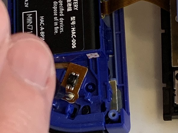

  5. Joy-Con ZL Switch Replacement, Splitting it apart: crwdns2935265:07crwdnd2935265:01crwdnd2935265:03crwdne2935265:0 Joy-Con ZL Switch Replacement, Splitting it apart: crwdns2935265:07crwdnd2935265:02crwdnd2935265:03crwdne2935265:0 Joy-Con ZL Switch Replacement, Splitting it apart: crwdns2935265:07crwdnd2935265:03crwdnd2935265:03crwdne2935265:0
    • Having removed the plastic button and 2 springs you uncover the switch and holding screw.
    • Remove the holding screw.

  8. Joy-Con ZL Switch Replacement, Pulling the plug on the problem....: crwdns2935265:010crwdnd2935265:01crwdnd2935265:01crwdne2935265:0
    • Gently pull on the ribbon cable to remove the plug from the socket.
    • Insert plug on new ribbon cable & switch.
    • You may need to push in the plug with plastic tweezers. Take care not to damage the cable.

  10. Joy-Con ZL Switch Replacement, Yippee it works!: crwdns2935265:012crwdnd2935265:01crwdnd2935265:03crwdne2935265:0 Joy-Con ZL Switch Replacement, Yippee it works!: crwdns2935265:012crwdnd2935265:02crwdnd2935265:03crwdne2935265:0 Joy-Con ZL Switch Replacement, Yippee it works!: crwdns2935265:012crwdnd2935265:03crwdnd2935265:03crwdne2935265:0
    • Put the two springs back on their retaining pins and push the button back into place.
    • It should click into place and when you push on the button you should hear the switch click.
    • Fold the cover back over and check there are no trapped wires before screwing back the 4 screws on the cover to complete the repair.
