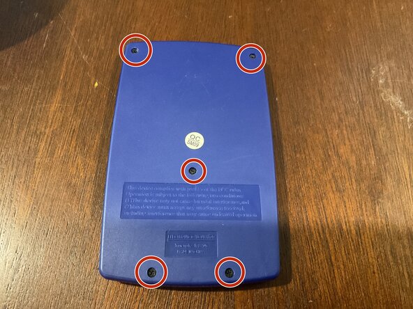

  1. Jot® Plastic 8-Digit Pocket Calculator Battery Replacement, Opening the Calculator: crwdns2935265:01crwdnd2935265:01crwdnd2935265:02crwdne2935265:0 Jot® Plastic 8-Digit Pocket Calculator Battery Replacement, Opening the Calculator: crwdns2935265:01crwdnd2935265:02crwdnd2935265:02crwdne2935265:0
    • First unscrew all the screws with a Phillips #000 Screwdriver
    • Then pull the case open

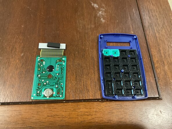

  2. Jot® Plastic 8-Digit Pocket Calculator Battery Replacement, Take the circuit board: crwdns2935265:02crwdnd2935265:01crwdnd2935265:01crwdne2935265:0
    • Take the circuit board out and put the shell on the side

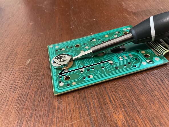

  3. Jot® Plastic 8-Digit Pocket Calculator Battery Replacement, Take out the battery: crwdns2935265:03crwdnd2935265:01crwdnd2935265:01crwdne2935265:0
    • Push the battery out with your Phillips #000 Screwdriver
