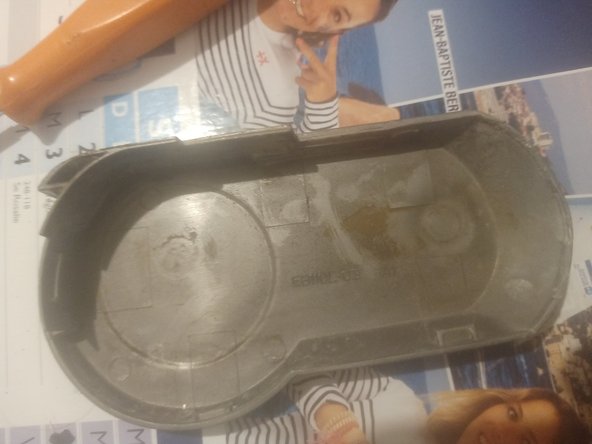

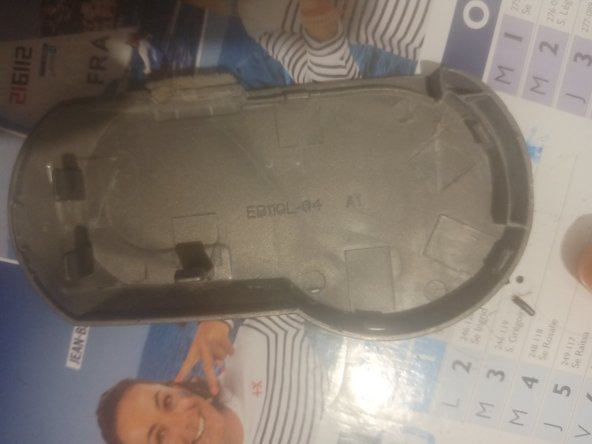

  1. Jimmy jv85 main brush teardown, Remove the side carters and top screws: crwdns2935265:01crwdnd2935265:01crwdnd2935265:03crwdne2935265:0 Jimmy jv85 main brush teardown, Remove the side carters and top screws: crwdns2935265:01crwdnd2935265:02crwdnd2935265:03crwdne2935265:0 Jimmy jv85 main brush teardown, Remove the side carters and top screws: crwdns2935265:01crwdnd2935265:03crwdnd2935265:03crwdne2935265:0
    • The side carters are just clipsed, use a flat screwdriver. Help yourself with the pictures to locate the clips
    • The screws location is indicated by the red circles.
  2. Jimmy jv85 main brush teardown, Remove the screws below: crwdns2935265:02crwdnd2935265:01crwdnd2935265:01crwdne2935265:0
    • Some of them are deep so use a long philips screwdriver.
    • The yellow circles show the wheels that need removal because there are screws located below.
    • Do not unscrew behind the sticker, this is useless
  3. Jimmy jv85 main brush teardown: crwdns2935265:03crwdnd2935265:01crwdnd2935265:01crwdne2935265:0
    • You're done
