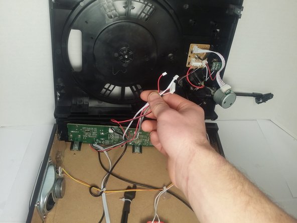

  7. Jensen JTA-230 Motor Replacement: crwdns2935265:07crwdnd2935265:01crwdnd2935265:02crwdne2935265:0 Jensen JTA-230 Motor Replacement: crwdns2935265:07crwdnd2935265:02crwdnd2935265:02crwdne2935265:0
    • Gently Pull the top off of the sides and flip over to reveal the circuitry.
    • To remove the top entirely, remove each electrical connection with a pair of tweezers. There are 3, each connecting to the speakers.
  8. Jensen JTA-230 Motor Replacement: crwdns2935265:08crwdnd2935265:01crwdnd2935265:01crwdne2935265:0
    • Remove the Motor from the record player
    • Using a soldering iron, remove the motor from the circuitry.
    • Replace motor with new one.
