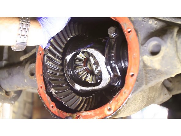

  3. Jeep Differential Fluid Replacement, Check for damage: crwdns2935265:03crwdnd2935265:01crwdnd2935265:02crwdne2935265:0 Jeep Differential Fluid Replacement, Check for damage: crwdns2935265:03crwdnd2935265:02crwdnd2935265:02crwdne2935265:0
    • While the cover is off, inspect the ring gear, pinion gear, and spider gears for any damage or missing/broken teeth
    • source
    • Make sure the vehicle is in neutral so you can spin the gears
    • Check for metal shavings or sludge at the bottom of the differential
    • source.

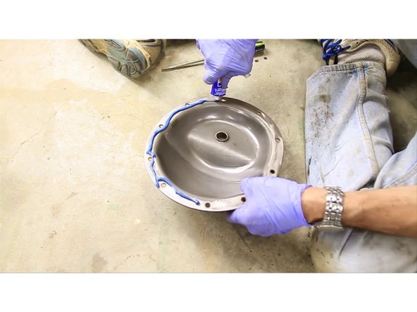

  6. Jeep Differential Fluid Replacement, Apply RTV: crwdns2935265:06crwdnd2935265:01crwdnd2935265:02crwdne2935265:0 Jeep Differential Fluid Replacement, Apply RTV: crwdns2935265:06crwdnd2935265:02crwdnd2935265:02crwdne2935265:0
    • Apply a bead of RTV sealant around the mating surface of the differential cover, making sure to go around each bolt hole
    • source
    • Use a dry finger to spread the RTV evenly over the surface
    • source
    • Let it sit for a minute to become tacky.
