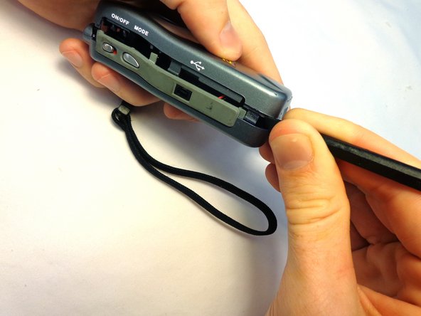

    • Flip the device so that the bottom is facing upwards. Using thumb, push the tab on the bottom in the direction indicated by the arrow and then lift the unhinged part of the tab.

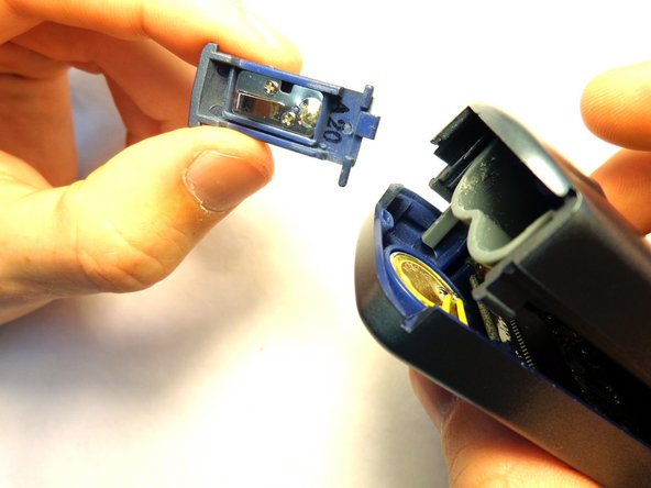

    • Tilt device so that batteries slide out.
  3. Jazz Digi-Stix JDC11 Power Switch Replacement, Power Switch: crwdns2935265:03crwdnd2935265:01crwdnd2935265:03crwdne2935265:0 Jazz Digi-Stix JDC11 Power Switch Replacement, Power Switch: crwdns2935265:03crwdnd2935265:02crwdnd2935265:03crwdne2935265:0 Jazz Digi-Stix JDC11 Power Switch Replacement, Power Switch: crwdns2935265:03crwdnd2935265:03crwdnd2935265:03crwdne2935265:0

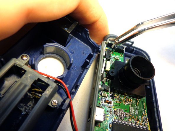

    • Carefully insert the flat end of the spudger into the seam on the top side of the device. Carefully twist the spudger to open the device. Repeat this step at incremental locations around the seam of the device until the two case halves separate.
    • Before completely separating the two halves, separate the case from the battery compartment cover, pulling the case apart. Take care not to break the plastic hinge as the battery compartment cover is removed.

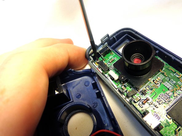

    • Make sure to take care in prying case apart. There are two wires (one red and one black) that could get disconnected from the motherboard.
    • Gently seperate the two halves of the device.
    • To remove the circuit board from the right section of the device, unscrew the two 5.6 mm Phillips #00 screws.
    • When the screws have been fully unscrewed, use the tweezers to remove them from the device.

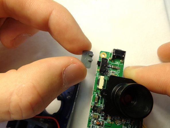

    • Carefully lift the circuit board from the casing. Be sure to not detach the wires from the circuit board or the case.
    • The power switch is located on the upper left side of the board. Pull the switch sideways from the circuit board to remove it.
