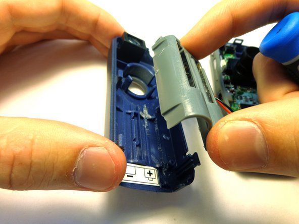

      • Carefully insert the flat end of the spudger into the seam on the top side of the device. Carefully twist the spudger to open the device. Repeat this step at incremental locations around the seam of the device until the two case halves separate.
      • Before completely separating the two halves, separate the case from the battery compartment cover, pulling the case apart. Take care not to break the plastic hinge as the battery compartment cover is removed.
    2. Jazz Digi-Stix JDC11 Case Replacement: crwdns2935265:04crwdnd2935265:01crwdnd2935265:03crwdne2935265:0 Jazz Digi-Stix JDC11 Case Replacement: crwdns2935265:04crwdnd2935265:02crwdnd2935265:03crwdne2935265:0 Jazz Digi-Stix JDC11 Case Replacement: crwdns2935265:04crwdnd2935265:03crwdnd2935265:03crwdne2935265:0
      • There are two wires (one red and one black) that could get disconnected from the motherboard when prying the case apart.
      • Gently seperate the two halves of the device.

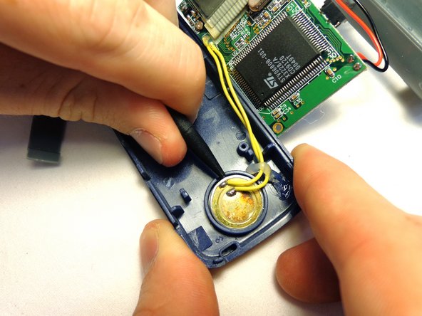

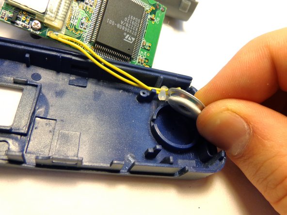

    1. Jazz Digi-Stix JDC11 Case Replacement, Board/Microphone/Battery Compartment: crwdns2935265:07crwdnd2935265:01crwdnd2935265:03crwdne2935265:0 Jazz Digi-Stix JDC11 Case Replacement, Board/Microphone/Battery Compartment: crwdns2935265:07crwdnd2935265:02crwdnd2935265:03crwdne2935265:0 Jazz Digi-Stix JDC11 Case Replacement, Board/Microphone/Battery Compartment: crwdns2935265:07crwdnd2935265:03crwdnd2935265:03crwdne2935265:0
      • To remove the microphone from the case, insert the tip of the spudger under the microphone's edge and pry it away from the case.

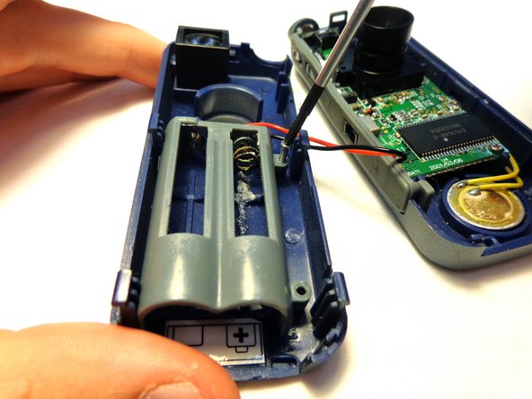

    2. Jazz Digi-Stix JDC11 Case Replacement: crwdns2935265:08crwdnd2935265:01crwdnd2935265:03crwdne2935265:0 Jazz Digi-Stix JDC11 Case Replacement: crwdns2935265:08crwdnd2935265:02crwdnd2935265:03crwdne2935265:0 Jazz Digi-Stix JDC11 Case Replacement: crwdns2935265:08crwdnd2935265:03crwdnd2935265:03crwdne2935265:0
      • Unscrew the three 5.6 mm Phillips #00 screws that connect the battery compartment to the case.
      • Remove the battery compartment from the case of the device.

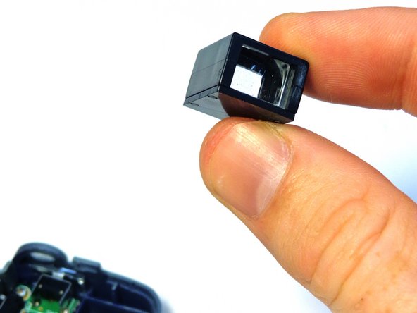

    1. Jazz Digi-Stix JDC11 Case Replacement, Case: crwdns2935265:09crwdnd2935265:01crwdnd2935265:02crwdne2935265:0 Jazz Digi-Stix JDC11 Case Replacement, Case: crwdns2935265:09crwdnd2935265:02crwdnd2935265:02crwdne2935265:0
      • Remove viewer from the top-left corner of the case by gently pulling it away.
