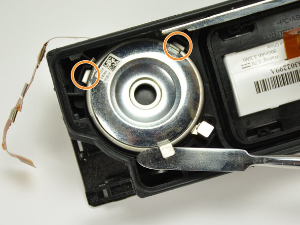

  10. Jawbone MINI JAMBOX Speaker Replacement, Speaker: crwdns2935265:010crwdnd2935265:01crwdnd2935265:02crwdne2935265:0 Jawbone MINI JAMBOX Speaker Replacement, Speaker: crwdns2935265:010crwdnd2935265:02crwdnd2935265:02crwdne2935265:0
    • In order to remove the speakers, you must rotate them. Rotate the circled tabs away from their adjacent tabs.
    • Once the speakers are completely rotated, you should see new tabs rotate into sight (see the orange marks).
  11. Jawbone MINI JAMBOX Speaker Replacement: crwdns2935265:011crwdnd2935265:01crwdnd2935265:01crwdne2935265:0
    • Carefully lift the speaker out of the plastic casing using the rotated metal tabs.
  12. Jawbone MINI JAMBOX Speaker Replacement: crwdns2935265:012crwdnd2935265:01crwdnd2935265:01crwdne2935265:0
    • Replace the blown speaker with a new one and reassemble the JAMBOX.
