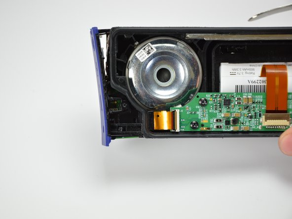

    • Push against the side without end cap to slide the internal components out of the case.
    • While holding the metal outset casing with one hand, press on the black inner plastic casing with your thumb.
    • It will be very difficult the first time. There is a rubber seal on the outside of the plastic inner case that creates a lot of friction with the metal outer case.

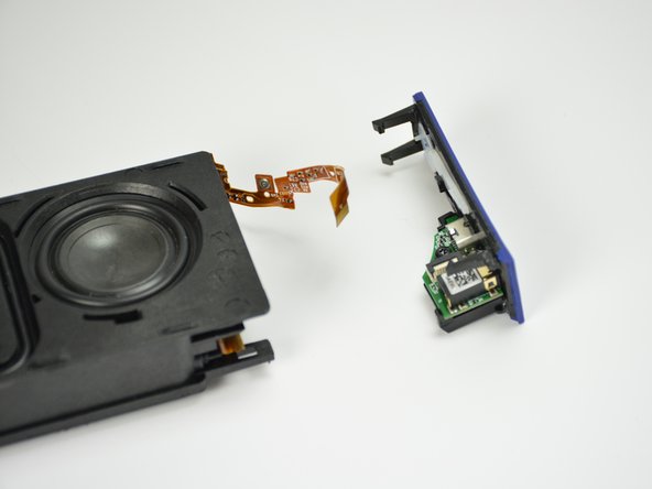

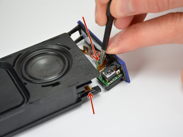

    • Carefully lift out the end panel.
    • Unplug both the connection ribbon and the ZIF or "zero insertion force" ribbon using tweezers or your hands.
    • There is a bit of glue to hold the connection ribbon down.
