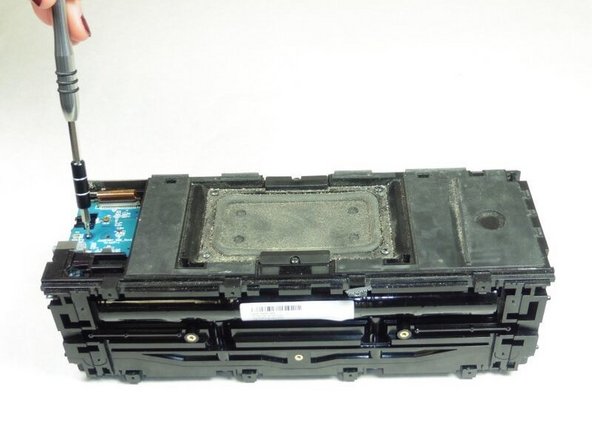

    1. Jawbone Big Jambox Micro USB Port Replacement, Micro USB Port: crwdns2935265:011crwdnd2935265:01crwdnd2935265:02crwdne2935265:0 Jawbone Big Jambox Micro USB Port Replacement, Micro USB Port: crwdns2935265:011crwdnd2935265:02crwdnd2935265:02crwdne2935265:0
      • Remove the indicated T6 7.4 mm screw holding the auxiliary board in place.
      • Carefully lift the auxiliary board up and off to the side.

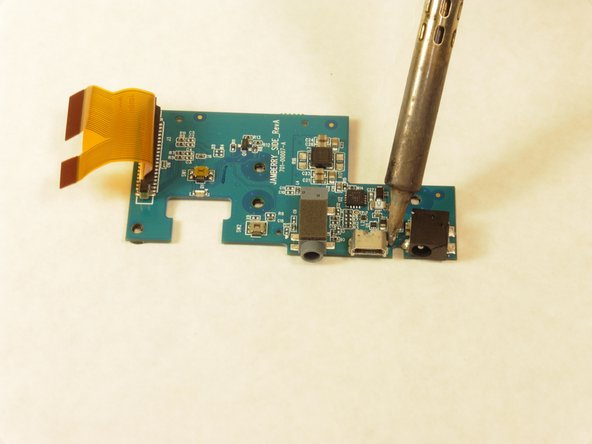

    2. Jawbone Big Jambox Micro USB Port Replacement: crwdns2935265:012crwdnd2935265:01crwdnd2935265:02crwdne2935265:0 Jawbone Big Jambox Micro USB Port Replacement: crwdns2935265:012crwdnd2935265:02crwdnd2935265:02crwdne2935265:0
      • With the auxiliary board removed, use a soldering iron to heat the metal attaching the Micro USB port (indicated on the image).
      • Remove the Micro USB port.
      • Exercise caution when handling the soldering iron due to extreme heat.
