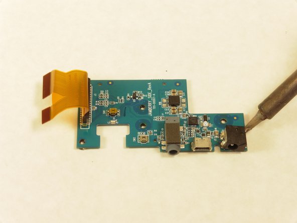

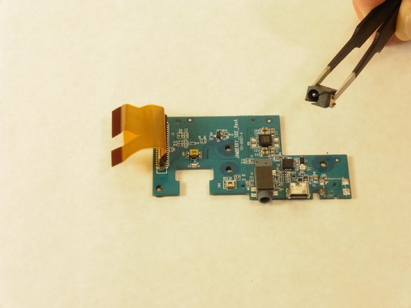

  12. Jawbone Big Jambox Charge Port Replacement: crwdns2935265:012crwdnd2935265:01crwdnd2935265:03crwdne2935265:0 Jawbone Big Jambox Charge Port Replacement: crwdns2935265:012crwdnd2935265:02crwdnd2935265:03crwdne2935265:0 Jawbone Big Jambox Charge Port Replacement: crwdns2935265:012crwdnd2935265:03crwdnd2935265:03crwdne2935265:0
    • With the auxiliary board removed, use a soldering iron to heat the metal keeping the charge port (indicated on image) intact.
    • Remove the charge port from the auxiliary board.
    • Exercise caution when handling the soldering iron due to extreme heat.
  13. Jawbone Big Jambox Charge Port Replacement, Charger port part replacement info: crwdns2935265:013crwdnd2935265:01crwdnd2935265:02crwdne2935265:0 Jawbone Big Jambox Charge Port Replacement, Charger port part replacement info: crwdns2935265:013crwdnd2935265:02crwdnd2935265:02crwdne2935265:0
    • The new charge port will need to be soldered to the logic board. For an exact match use Digi-Key part number CP-018HPJCT-ND
  14. Jawbone Big Jambox Charge Port Replacement, Determine all 4 PCB contacts for charging post: crwdns2935265:014crwdnd2935265:01crwdnd2935265:02crwdne2935265:0 Jawbone Big Jambox Charge Port Replacement, Determine all 4 PCB contacts for charging post: crwdns2935265:014crwdnd2935265:02crwdnd2935265:02crwdne2935265:0
    • With a multimeter, test all 3 PCB contacts to determine which are positive, negative and ground. Similarly, ascertain each terminal of your "new" charger port and its corresponding PCB contact. Your "new" port can be a brand-new, identical replacement or a salvaged one of approximate size, post thickness and terminal orientation.
    • Unless an identical part replacement, you may have to bend your ports terminals in order to make proper contact and'or enlarge the panel opening for the AC plug as I did. To avoid repeat part failure, I hot-glued my charger port onto my PCB after reinforcing my port's terminals with thicker wire and generous solder.
