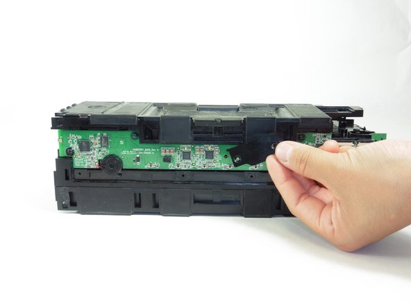

  14. Jawbone Big Jambox Button Circuit Board Replacement, Button Circuit Board: crwdns2935265:014crwdnd2935265:01crwdnd2935265:03crwdne2935265:0 Jawbone Big Jambox Button Circuit Board Replacement, Button Circuit Board: crwdns2935265:014crwdnd2935265:02crwdnd2935265:03crwdne2935265:0 Jawbone Big Jambox Button Circuit Board Replacement, Button Circuit Board: crwdns2935265:014crwdnd2935265:03crwdnd2935265:03crwdne2935265:0
    • Remove the two PH0, 5.8 mm screws on the small plastic black panel using a screwdriver.
  15. Jawbone Big Jambox Button Circuit Board Replacement: crwdns2935265:015crwdnd2935265:01crwdnd2935265:01crwdne2935265:0
    • Pull out rubber stopper using your fingers.

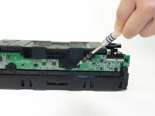

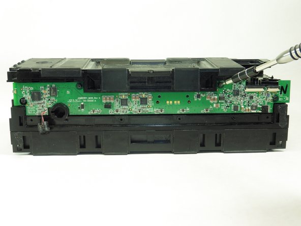

  16. Jawbone Big Jambox Button Circuit Board Replacement: crwdns2935265:016crwdnd2935265:01crwdnd2935265:02crwdne2935265:0 Jawbone Big Jambox Button Circuit Board Replacement: crwdns2935265:016crwdnd2935265:02crwdnd2935265:02crwdne2935265:0
    • Remove the four T6, 9.9mm screws that secure the button circuit board to the body
  17. Jawbone Big Jambox Button Circuit Board Replacement: crwdns2935265:017crwdnd2935265:01crwdnd2935265:01crwdne2935265:0
    • Minding the small L-shaped piece of metal on the end opposite of the ports, lift the circuit board from the body of the Big Jambox.
