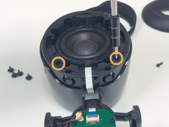

  3. Jam Voice Speaker Replacement: crwdns2935265:03crwdnd2935265:01crwdnd2935265:02crwdne2935265:0 Jam Voice Speaker Replacement: crwdns2935265:03crwdnd2935265:02crwdnd2935265:02crwdne2935265:0
    • Remove the four 5mm Phillips screws that hold down the speaker in place.
    • Remove the two 6mm Phillips screws that hold down the plastic casing.

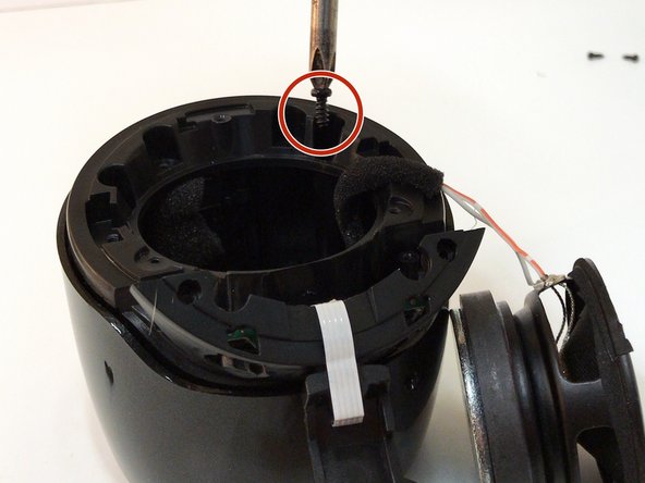

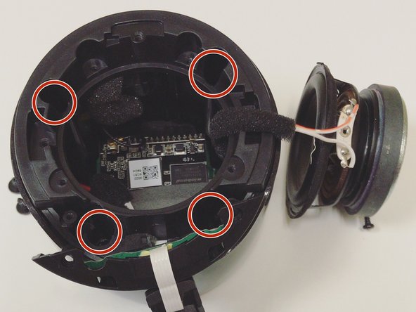

    • Remove the four 7mm Phillips screws to expose the motherboard.
  6. Jam Voice Speaker Replacement: crwdns2935265:06crwdnd2935265:01crwdnd2935265:01crwdne2935265:0
    • After removing all of the screws from the plastic cover, remove it by pulling up and out.
    • Be careful not to pull and damage any of the wires.

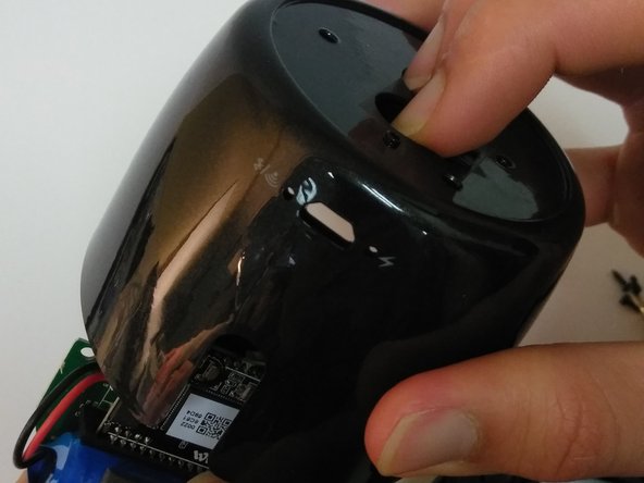

  8. Jam Voice Speaker Replacement, Speaker: crwdns2935265:08crwdnd2935265:01crwdnd2935265:01crwdne2935265:0
    • Use tweezers to pull out the speaker's wire from the motherboard.
    • Use tweezers to pull out the battery's wire from the motherboard.
    • The speaker's connection point is opposite the battery's connection point.
