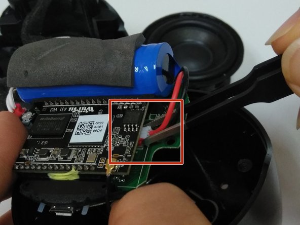

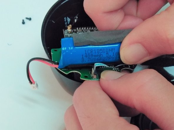

    1. Jam Voice Battery Replacement, Battery: crwdns2935265:08crwdnd2935265:01crwdnd2935265:03crwdne2935265:0 Jam Voice Battery Replacement, Battery: crwdns2935265:08crwdnd2935265:02crwdnd2935265:03crwdne2935265:0 Jam Voice Battery Replacement, Battery: crwdns2935265:08crwdnd2935265:03crwdnd2935265:03crwdne2935265:0
      • Expose the motherboard and battery and place in a position that will be easy to access and work with.
      • Use tweezers to remove the battery's wire from the motherboard at the connection point.
      • The battery's connection point is opposite the speaker's connection point.
      • Pull the battery from the motherboard.
