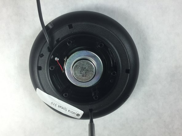

    • Using a metal spudger, peel back the foam pad on the bottom of the device to reveal six screws.
  2. Jabra Speak 510 Outer Casing Replacement: crwdns2935265:02crwdnd2935265:01crwdnd2935265:01crwdne2935265:0
    • Remove the six 20 mm T6 screws from the bottom of the device.
  3. Jabra Speak 510 Outer Casing Replacement: crwdns2935265:03crwdnd2935265:01crwdnd2935265:02crwdne2935265:0 Jabra Speak 510 Outer Casing Replacement: crwdns2935265:03crwdnd2935265:02crwdnd2935265:02crwdne2935265:0
    • Remove the back plate and the grey foam underneath.
  4. Jabra Speak 510 Outer Casing Replacement: crwdns2935265:04crwdnd2935265:01crwdnd2935265:03crwdne2935265:0 Jabra Speak 510 Outer Casing Replacement: crwdns2935265:04crwdnd2935265:02crwdnd2935265:03crwdne2935265:0 Jabra Speak 510 Outer Casing Replacement: crwdns2935265:04crwdnd2935265:03crwdnd2935265:03crwdne2935265:0
    • Use a small, pointed metal spudger to release the plastic tabs connecting the faceplate to the bottom of the speaker.
    • A small cable connects the faceplate to the device. Carefully disconnect the cable before fully opening the device.
    • Slowly flip the device open like a clam shell.
    • There are several wires soldered to the motherboard that prevent the faceplate from detaching completely.
