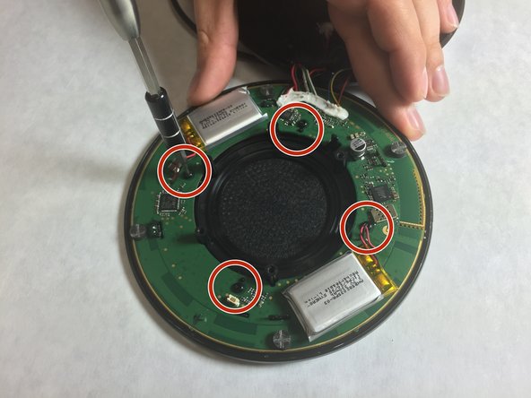

  5. Jabra Speak 510 Motherboard Replacement, Motherboard: crwdns2935265:05crwdnd2935265:01crwdnd2935265:02crwdne2935265:0 Jabra Speak 510 Motherboard Replacement, Motherboard: crwdns2935265:05crwdnd2935265:02crwdnd2935265:02crwdne2935265:0
    • Using the T6 Torx Screwdriver, remove the four (4mm) screws.
  6. Jabra Speak 510 Motherboard Replacement: crwdns2935265:06crwdnd2935265:01crwdnd2935265:01crwdne2935265:0
    • After removing the screws, take out the center covering to free the motherboard by lifting the tabs and pulling it off.

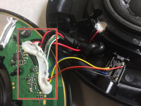

  7. Jabra Speak 510 Motherboard Replacement: crwdns2935265:07crwdnd2935265:01crwdnd2935265:02crwdne2935265:0 Jabra Speak 510 Motherboard Replacement: crwdns2935265:07crwdnd2935265:02crwdnd2935265:02crwdne2935265:0
    • Peel off the white adhesive to desolder the connections underneath.
    • Desolder the wires connected to the motherboard.
    • You can find soldering tips in the How To Solder and Desolder Connections guide.
    • Keep track of where the wires are connected. When re-assembling you will have to connect the wires in the correct spot.

Walaa Maher - crwdns2934203:0crwdne2934203:0
Be very careful when desoldering the connector cables! The soldering lugs are poor quality and tend to tear off the PCB
