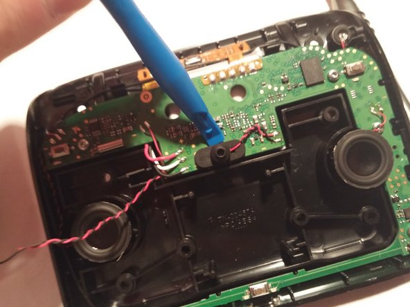

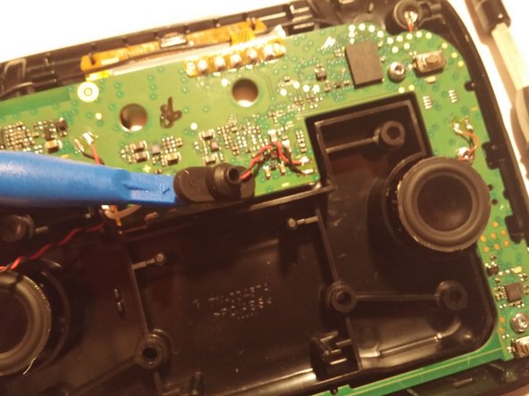

  4. Jabra Freeway Motion Detector Replacement, Motion Detector: crwdns2935265:04crwdnd2935265:01crwdnd2935265:03crwdne2935265:0 Jabra Freeway Motion Detector Replacement, Motion Detector: crwdns2935265:04crwdnd2935265:02crwdnd2935265:03crwdne2935265:0 Jabra Freeway Motion Detector Replacement, Motion Detector: crwdns2935265:04crwdnd2935265:03crwdnd2935265:03crwdne2935265:0
    • Use the plastic opening tool to lift the motion detector off the circuit board.
    • The motion detector is glued in place, so a moderate amount of force is required.
  5. Jabra Freeway Motion Detector Replacement: crwdns2935265:05crwdnd2935265:01crwdnd2935265:01crwdne2935265:0
    • Desolder the two wires connecting the motion detector to the circuit board.
    • Please refer to the soldering technique guide for instructions on desoldering and soldering.

Based on my limited experience with this device, the component being replaced here is the primary microphone - not the motion detector as claimed. The other video showing replacement of the microphone is actually the secondary, or noise-cancelling microphone. I don’t know the exact components for the motion detector, but I’m quite sure that this is not that component.
