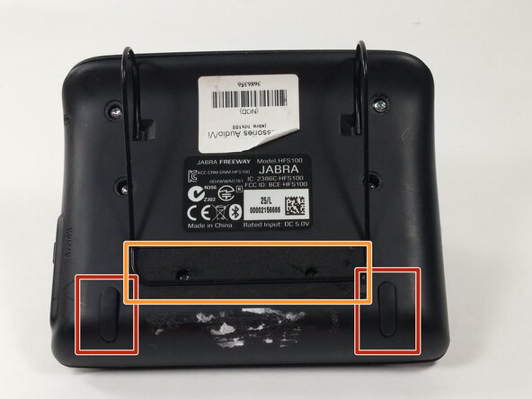

    • Turn off the device before proceeding. Failure to do so may result in device damage or injury to oneself.
    • Remove the rubber pads from the bottom of the device using the spudger.
    • Remove the foam tape covering 2 hidden screws from the back of the device.
  2. Jabra Freeway Battery Replacement: crwdns2935265:02crwdnd2935265:01crwdnd2935265:03crwdne2935265:0 Jabra Freeway Battery Replacement: crwdns2935265:02crwdnd2935265:02crwdnd2935265:03crwdne2935265:0 Jabra Freeway Battery Replacement: crwdns2935265:02crwdnd2935265:03crwdnd2935265:03crwdne2935265:0
    • Remove the eight 6mm T9 screws.
    • Two of these screws are underneath the foam padding. This padding is glued on and will be destroyed in this process. Poking through the foam minimizes the damage to the device.

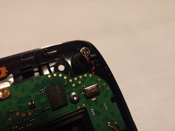

    • Remove the five 6mm T6 screws connecting the circuit board to the rear panel.
  6. Jabra Freeway Battery Replacement: crwdns2935265:06crwdnd2935265:01crwdnd2935265:03crwdne2935265:0 Jabra Freeway Battery Replacement: crwdns2935265:06crwdnd2935265:02crwdnd2935265:03crwdne2935265:0 Jabra Freeway Battery Replacement: crwdns2935265:06crwdnd2935265:03crwdnd2935265:03crwdne2935265:0

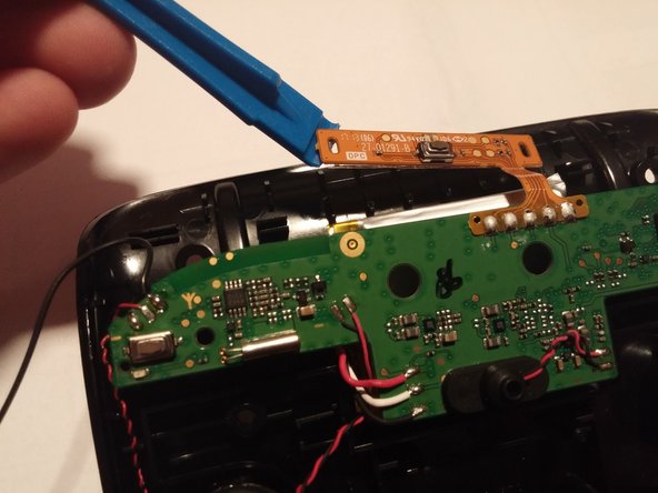

    • Remove the microphone from microphone slot.
  7. Jabra Freeway Battery Replacement: crwdns2935265:07crwdnd2935265:01crwdnd2935265:03crwdne2935265:0 Jabra Freeway Battery Replacement: crwdns2935265:07crwdnd2935265:02crwdnd2935265:03crwdne2935265:0 Jabra Freeway Battery Replacement: crwdns2935265:07crwdnd2935265:03crwdnd2935265:03crwdne2935265:0
    • Carefully use the plastic opening tool to lift the circuit board up.

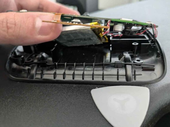

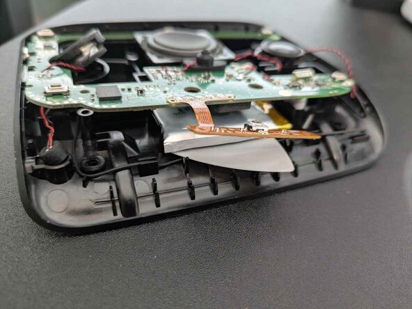

  8. Jabra Freeway Battery Replacement: crwdns2935265:08crwdnd2935265:01crwdnd2935265:02crwdne2935265:0 Jabra Freeway Battery Replacement: crwdns2935265:08crwdnd2935265:02crwdnd2935265:02crwdne2935265:0
    • FIRE HAZARD. Avoid damaging the battery for this step!
    • Do not use a metal tool for this step.
    • Do not bend or puncture the battery!
    • There is adhesive covering the entire lower side of the battery.
    • Insert a guitar pick or thin plastic tool of some kind to detach the old battery from the case.
  9. Jabra Freeway Battery Replacement: crwdns2935265:09crwdnd2935265:01crwdnd2935265:01crwdne2935265:0
    • Desolder the three wires connecting the battery.
    • Please refer to the soldering technique guide for instructions on desoldering and soldering.
