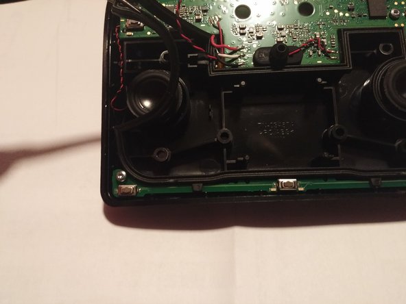

    • Gently lift the front panel off of the device and carefully rest it to the side.
  4. Jabra Freeway Antenna Replacement, Antenna: crwdns2935265:04crwdnd2935265:01crwdnd2935265:02crwdne2935265:0 Jabra Freeway Antenna Replacement, Antenna: crwdns2935265:04crwdnd2935265:02crwdnd2935265:02crwdne2935265:0
    • Carefully remove the rubber gasket using the tweezers.

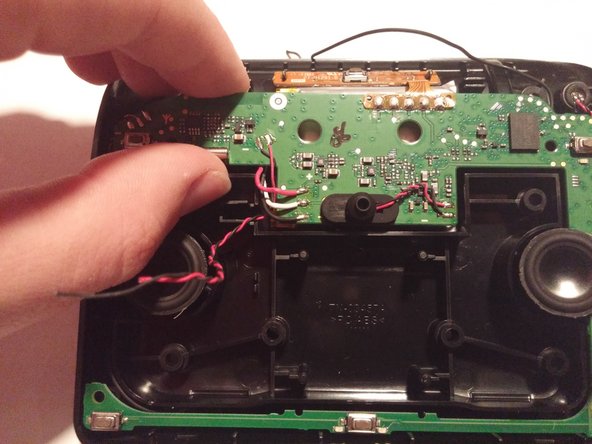

    • Remove the five 6mm T6 screws connecting the circuit board to the rear panel.
  6. Jabra Freeway Antenna Replacement: crwdns2935265:06crwdnd2935265:01crwdnd2935265:03crwdne2935265:0 Jabra Freeway Antenna Replacement: crwdns2935265:06crwdnd2935265:02crwdnd2935265:03crwdne2935265:0 Jabra Freeway Antenna Replacement: crwdns2935265:06crwdnd2935265:03crwdnd2935265:03crwdne2935265:0
    • Remove the microphone from microphone slot using tweezers.

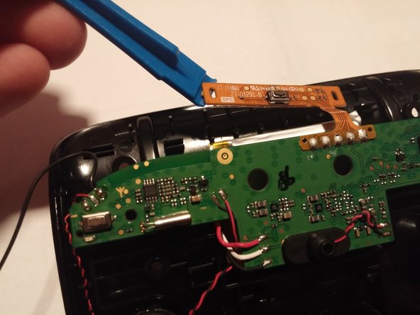

    • Carefully use the plastic opening tool to lift the circuit board up.
    • The orange portion of the circuit board is glued into place, and a small amount of force is necessary to break it free from the adhesive.

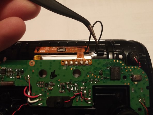

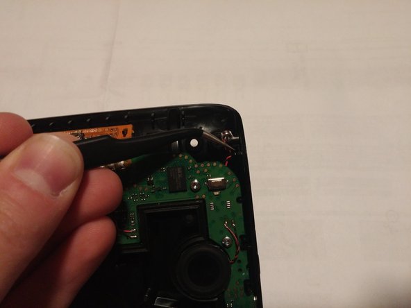

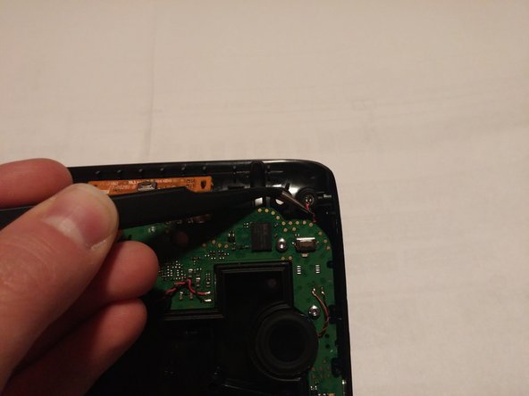

  8. Jabra Freeway Antenna Replacement: crwdns2935265:08crwdnd2935265:01crwdnd2935265:02crwdne2935265:0 Jabra Freeway Antenna Replacement: crwdns2935265:08crwdnd2935265:02crwdnd2935265:02crwdne2935265:0
    • Use the tweezers to remove the antenna from the retaining clips.
