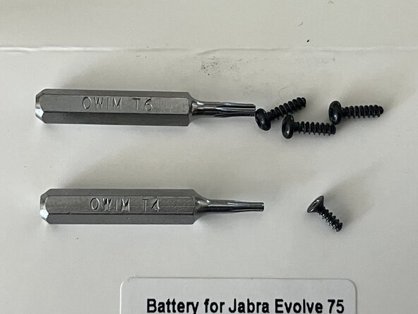

    • Get a new battery. The original name is: AHB572535PST and has the following specifications: 3.7V, 500mAh, 2 Wh.
    • I used the following battery with the same specifications (it's "only" 1.85 instead of 2.0Wh, but that doesn't matter) for around €16 (bottom model in the photo): https://www.accuswiss.ch/product_info.ph...
    • You need a T4 screwdriver for the screw on the outside of the case.
    • For the three screws inside the case, you need a T6 screwdriver.
    • To remove the old battery, you need a spudger (or a guitar pick will also work).

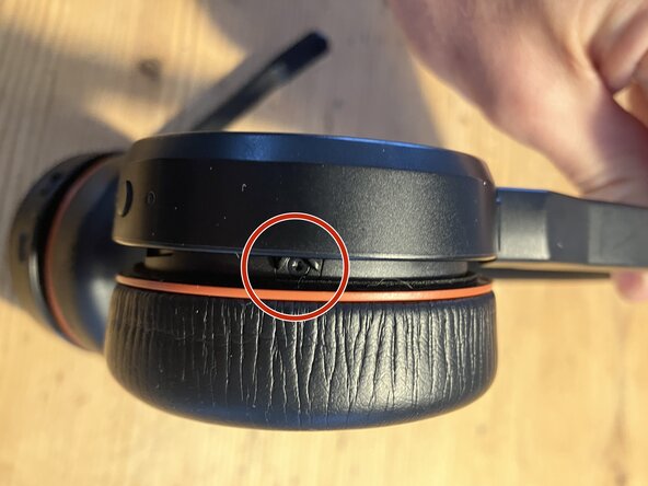

  3. Jabra Evolve 75 battery replacement, Loosen the screw: crwdns2935265:03crwdnd2935265:01crwdnd2935265:02crwdne2935265:0 Jabra Evolve 75 battery replacement, Loosen the screw: crwdns2935265:03crwdnd2935265:02crwdnd2935265:02crwdne2935265:0
    • Loosen the screw on the side without the microphone (arrow) using a T4 screwdriver.
    • Remove the screw and store it in a safe place.

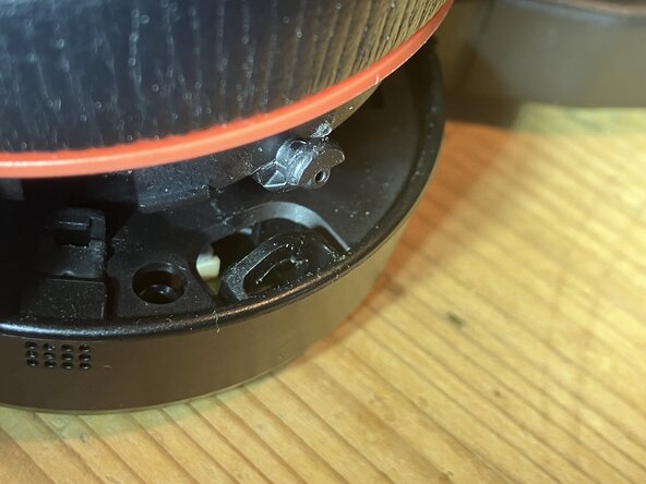

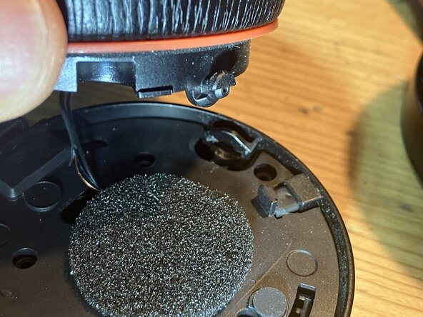

  4. Jabra Evolve 75 battery replacement, opening the case: crwdns2935265:04crwdnd2935265:01crwdnd2935265:03crwdne2935265:0 Jabra Evolve 75 battery replacement, opening the case: crwdns2935265:04crwdnd2935265:02crwdnd2935265:03crwdne2935265:0 Jabra Evolve 75 battery replacement, opening the case: crwdns2935265:04crwdnd2935265:03crwdnd2935265:03crwdne2935265:0
    • Now comes the hardest part: You have to unlatch the earpiece. This requires a delicate touch and patience!
    • The earpiece is attached to a hook on the right side (opposite the loosened screw). To unlatch, you first have to press the earpiece down on the hooked side (blue arrow) and then simultaneously turn it to the left (green arrows). To do this, gently move the earpiece back and forth.
    • First, watch the video in the next step.
    • The last two images show the unhooked earpiece.
    • Don't force it, just try to find the right twist ;-)

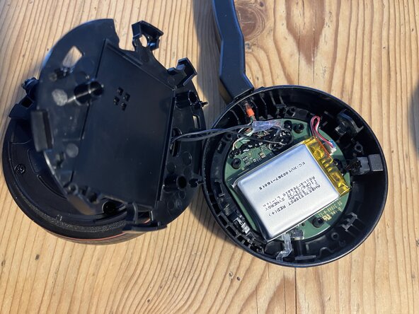

  5. Jabra Evolve 75 battery replacement, Remove the battery holder: crwdns2935265:06crwdnd2935265:01crwdnd2935265:02crwdne2935265:0 Jabra Evolve 75 battery replacement, Remove the battery holder: crwdns2935265:06crwdnd2935265:02crwdnd2935265:02crwdne2935265:0
    • Loosen the three screws with a T6 screwdriver
    • Be careful not to lose the green-marked part
    • Remove the black cover and fold it aside
    • Be careful not to damage the delicate speaker cables
  6. Jabra Evolve 75 battery replacement, Remove the old battery: crwdns2935265:07crwdnd2935265:01crwdnd2935265:01crwdne2935265:0
    • unplug the old battery
    • Carefully remove the old battery from the circuit board using a spudger. CAUTION: Do not use sharp objects and do not damage the old battery under any circumstances! LiPo batteries can catch fire if subjected to pressure or damage!

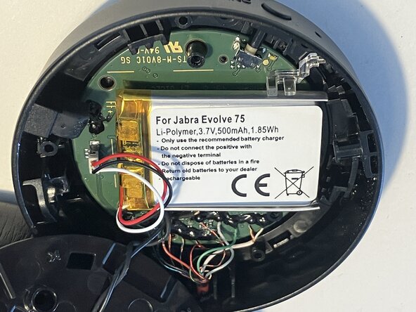

  7. Jabra Evolve 75 battery replacement, Insert new battery: crwdns2935265:08crwdnd2935265:01crwdnd2935265:02crwdne2935265:0 Jabra Evolve 75 battery replacement, Insert new battery: crwdns2935265:08crwdnd2935265:02crwdnd2935265:02crwdne2935265:0
    • attach double-sided tape to fix the battery on the cirquit board
    • Connect the new battery to the circuit board.

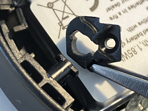

  8. Jabra Evolve 75 battery replacement, Assembly: crwdns2935265:09crwdnd2935265:01crwdnd2935265:02crwdne2935265:0 Jabra Evolve 75 battery replacement, Assembly: crwdns2935265:09crwdnd2935265:02crwdnd2935265:02crwdne2935265:0
    • Fix the black cover with three Torx T6 screws.
    • Latch the earpiece to the hook (this is much easier than unhooking it).
    • If the part circled in red fell out while opening, reinsert it correctly using tweezers (the countersunk hole for the screw must face upward and outward).
Follow the steps in reverse order to reassemble your device.
