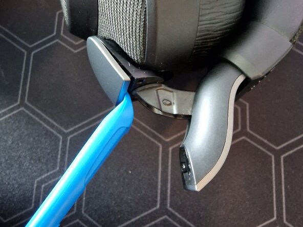

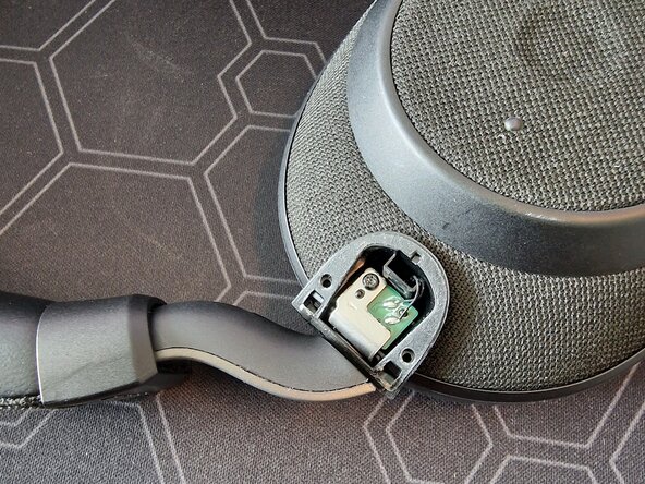

  1. Jabra Elite 85h on/off Switch Replacement, removing the plastic cap on the right side: crwdns2935265:01crwdnd2935265:01crwdnd2935265:03crwdne2935265:0 Jabra Elite 85h on/off Switch Replacement, removing the plastic cap on the right side: crwdns2935265:01crwdnd2935265:02crwdnd2935265:03crwdne2935265:0 Jabra Elite 85h on/off Switch Replacement, removing the plastic cap on the right side: crwdns2935265:01crwdnd2935265:03crwdnd2935265:03crwdne2935265:0
    • use a flathead 2 to Remove cap over the hinge, on the right side (same side as charging port)
    • help with prytool to get it open
    • opened

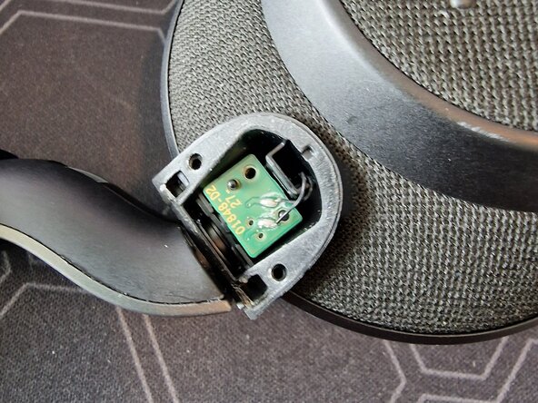

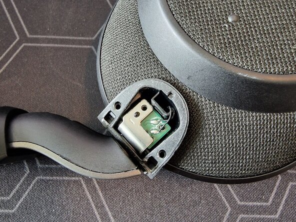

  2. Jabra Elite 85h on/off Switch Replacement, remove bracket: crwdns2935265:02crwdnd2935265:01crwdnd2935265:03crwdne2935265:0 Jabra Elite 85h on/off Switch Replacement, remove bracket: crwdns2935265:02crwdnd2935265:02crwdnd2935265:03crwdne2935265:0 Jabra Elite 85h on/off Switch Replacement, remove bracket: crwdns2935265:02crwdnd2935265:03crwdnd2935265:03crwdne2935265:0
    • remove t5 screw
    • lift up metal bracket
    • lift up PCB
    • desolder the microswitch
    • resolder the new micro switch
