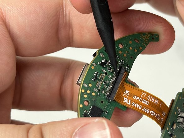

  7. Jabra Elite 85h Microphone Replacement, Microphone: crwdns2935265:07crwdnd2935265:01crwdnd2935265:02crwdne2935265:0 Jabra Elite 85h Microphone Replacement, Microphone: crwdns2935265:07crwdnd2935265:02crwdnd2935265:02crwdne2935265:0
    • Remove the four screws attaching the circuit boards to the headphone enclosure.
    • The microphone is located on the lower circuit board.
  8. Jabra Elite 85h Microphone Replacement: crwdns2935265:08crwdnd2935265:01crwdnd2935265:03crwdne2935265:0 Jabra Elite 85h Microphone Replacement: crwdns2935265:08crwdnd2935265:02crwdnd2935265:03crwdne2935265:0 Jabra Elite 85h Microphone Replacement: crwdns2935265:08crwdnd2935265:03crwdnd2935265:03crwdne2935265:0
    • Remove the circuit boards from the headphone enclosure.
    • Carefully lift the bar located on the lower circuit board that contains the 24-pin ribbon cable. Remove the cable.
