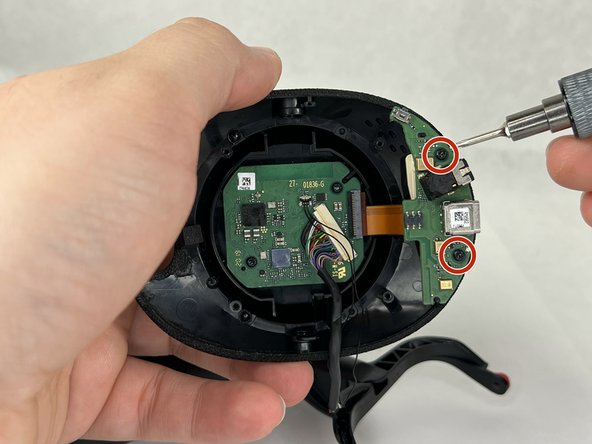

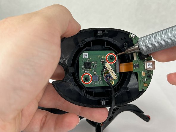

    • Remove the two screws holding the upper and lower circuit boards in place.
  8. Jabra Elite 85h Charging Port Replacement: crwdns2935265:08crwdnd2935265:01crwdnd2935265:03crwdne2935265:0 Jabra Elite 85h Charging Port Replacement: crwdns2935265:08crwdnd2935265:02crwdnd2935265:03crwdne2935265:0 Jabra Elite 85h Charging Port Replacement: crwdns2935265:08crwdnd2935265:03crwdnd2935265:03crwdne2935265:0
    • Remove the two attached circuit boards from the headphone housing.

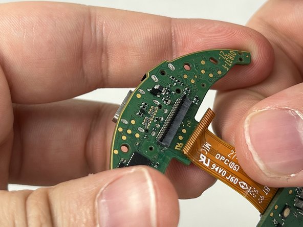

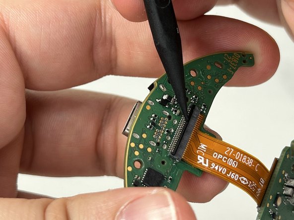

    • Carefully lift the bar holding the 24-pin ribbon cable in place and remove the cable.
    • Replace entire control board with charge port or de-solder charge port and replace.

Hi Ryan,
Regarding 'Step 8', do you know where I can get a replacement charging board? I'm in the UK.
My specific problem seems to be a short circuit - I lose all sound in the right earcup when the charging cable is attached and it moves. Sometimes moving it again or tapping the earcup brings the sound back but this is not ideal.
My hands shake from neurological problems so it would be very challenging to find and fix that loose / shorted connection, whereas a replacement board seems to be an ideal repair option.
Hope you can help,
Regards, Craig
Craig Bartlett - crwdns2934203:0crwdne2934203:0
Hi Craig, I had exacly the same issue. I thought that the reason is the unsoldered charging port. Today I opened right speaker and it turned out that the charging port is properly soldered but some of the solders were corroded/contaminated. I cleaned up the solder points using isopropyl alcohol. Then I bent a little bit the pins which connects the board (27-01837-F) with the speaker. After that the right speaker works fine even if the charging cable moves.
