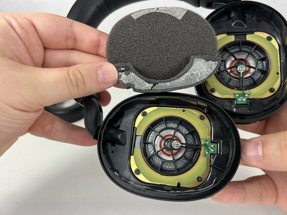

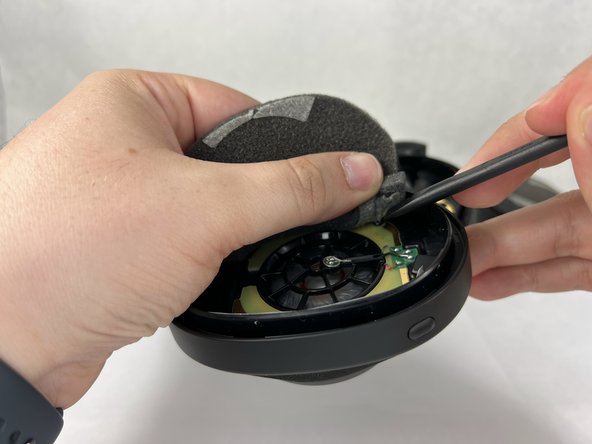

  2. Jabra Elite 85h Bluetooth Module Replacement: crwdns2935265:02crwdnd2935265:01crwdnd2935265:03crwdne2935265:0 Jabra Elite 85h Bluetooth Module Replacement: crwdns2935265:02crwdnd2935265:02crwdnd2935265:03crwdne2935265:0 Jabra Elite 85h Bluetooth Module Replacement: crwdns2935265:02crwdnd2935265:03crwdnd2935265:03crwdne2935265:0
    • The foam inserts and backing tape are very delicate, take your time when removing them and be careful to not rip or tear the material.
    • Using the small plastic spudger to assist, begin lifting up and removing the foam inserts with attached backing tape.
  3. Jabra Elite 85h Bluetooth Module Replacement: crwdns2935265:03crwdnd2935265:01crwdnd2935265:03crwdne2935265:0 Jabra Elite 85h Bluetooth Module Replacement: crwdns2935265:03crwdnd2935265:02crwdnd2935265:03crwdne2935265:0 Jabra Elite 85h Bluetooth Module Replacement: crwdns2935265:03crwdnd2935265:03crwdnd2935265:03crwdne2935265:0
    • Repeat previous steps on other side.

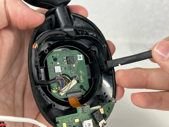

  6. Jabra Elite 85h Bluetooth Module Replacement: crwdns2935265:06crwdnd2935265:01crwdnd2935265:02crwdne2935265:0 Jabra Elite 85h Bluetooth Module Replacement: crwdns2935265:06crwdnd2935265:02crwdnd2935265:02crwdne2935265:0
    • Remove the two screws holding the upper and lower circuit boards in place.

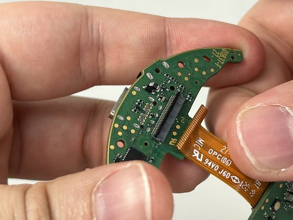

  7. Jabra Elite 85h Bluetooth Module Replacement: crwdns2935265:07crwdnd2935265:01crwdnd2935265:02crwdne2935265:0 Jabra Elite 85h Bluetooth Module Replacement: crwdns2935265:07crwdnd2935265:02crwdnd2935265:02crwdne2935265:0
    • Remove the two attached circuit boards from the headphone housing.
    • De-solder Bluetooth Module from control board to replace.
