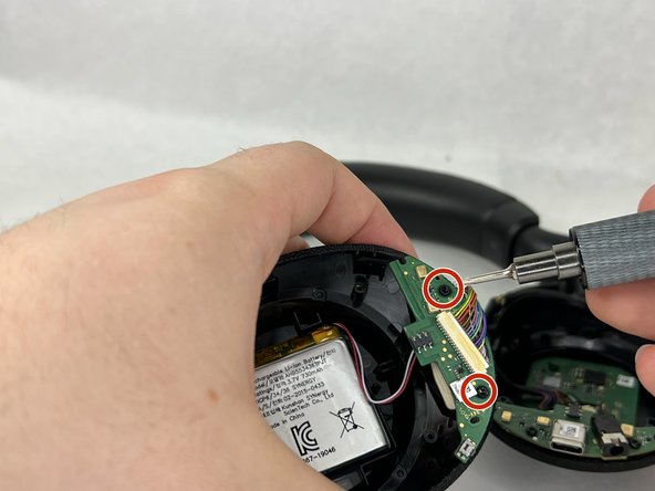

  9. Jabra Elite 85h Battery Replacement: crwdns2935265:09crwdnd2935265:01crwdnd2935265:02crwdne2935265:0 Jabra Elite 85h Battery Replacement: crwdns2935265:09crwdnd2935265:02crwdnd2935265:02crwdne2935265:0
    • Unscrew the two screws holding the motherboard in place and remove the motherboard from the enclosure.
  10. Jabra Elite 85h Battery Replacement: crwdns2935265:010crwdnd2935265:01crwdnd2935265:03crwdne2935265:0 Jabra Elite 85h Battery Replacement: crwdns2935265:010crwdnd2935265:02crwdnd2935265:03crwdne2935265:0 Jabra Elite 85h Battery Replacement: crwdns2935265:010crwdnd2935265:03crwdnd2935265:03crwdne2935265:0
    • Flip the motherboard to reveal a 2-pin JST connector. Carefully unplug the connector from the motherboard and use a plastic spudger to remove the battery from the enclosure.
