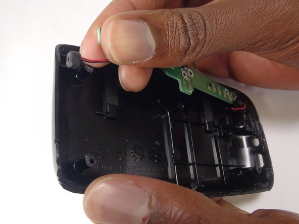

  4. Jabra CRUISER2 Status Display Replacement, Motherboard: crwdns2935265:04crwdnd2935265:01crwdnd2935265:02crwdne2935265:0 Jabra CRUISER2 Status Display Replacement, Motherboard: crwdns2935265:04crwdnd2935265:02crwdnd2935265:02crwdne2935265:0
    • Carefully detach the wire running from the speaker to the motherboard by unplugging it from the white socket.
  5. Jabra CRUISER2 Status Display Replacement: crwdns2935265:05crwdnd2935265:01crwdnd2935265:01crwdne2935265:0
    • Using the PH000, unscrew the three 4.55 mm screws in the motherboard.
    • The names of the screwdriver heads are listed on the sides of each head.
  6. Jabra CRUISER2 Status Display Replacement: crwdns2935265:06crwdnd2935265:01crwdnd2935265:01crwdne2935265:0
    • Remove the motherboard from the device by lifting it up from the back plate.
  7. Jabra CRUISER2 Status Display Replacement, Status Display: crwdns2935265:07crwdnd2935265:01crwdnd2935265:01crwdne2935265:0
    • Using the PH000, unscrew the three 4.6mm screws in the status display.
  8. Jabra CRUISER2 Status Display Replacement: crwdns2935265:08crwdnd2935265:01crwdnd2935265:02crwdne2935265:0 Jabra CRUISER2 Status Display Replacement: crwdns2935265:08crwdnd2935265:02crwdnd2935265:02crwdne2935265:0
    • Disconnect the wires connecting the status display to the back plate. Do this by pulling the wire from the black socket.
    • Do this with the wires on both sides of the status board.
  9. Jabra CRUISER2 Status Display Replacement: crwdns2935265:09crwdnd2935265:01crwdnd2935265:01crwdne2935265:0
    • Remove the status display by lifting it off of the back plate.
