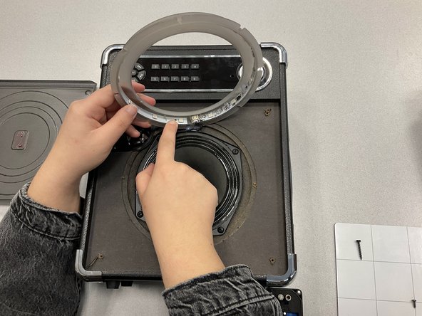

  3. JYX-S55 Speaker Replacement: crwdns2935265:03crwdnd2935265:01crwdnd2935265:02crwdne2935265:0 JYX-S55 Speaker Replacement: crwdns2935265:03crwdnd2935265:02crwdnd2935265:02crwdne2935265:0
    • Lift out the plastic ring which contains the lights.
    • The lights will be connected with wires. These do not need to be cut or ripped out; simply place the plastic ring off to the side or somewhere out of the way.
