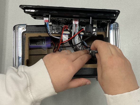

    • Remove the screws on the left and right side of the motherboard using a JIS #1 screwdriver.
    • It's important to keep these screws separate from the ones unscrewed from the top of the panel. This is so both sets of screws won't get mixed up.
  5. JYX-S55 Motherboard Replacement: crwdns2935265:05crwdnd2935265:01crwdnd2935265:03crwdne2935265:0 JYX-S55 Motherboard Replacement: crwdns2935265:05crwdnd2935265:02crwdnd2935265:03crwdne2935265:0 JYX-S55 Motherboard Replacement: crwdns2935265:05crwdnd2935265:03crwdnd2935265:03crwdne2935265:0

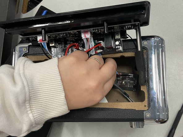

    • Detach the red and white bricks plugged into the motherboard.
    • This should allow the motherboard to be completely unattached from the device, and ready to handle.
    • Swap the current motherboard with the new replacement part. Then, plug the white brick into the port on the right of the replacement motherboard, and the red brick back in to the center port.
