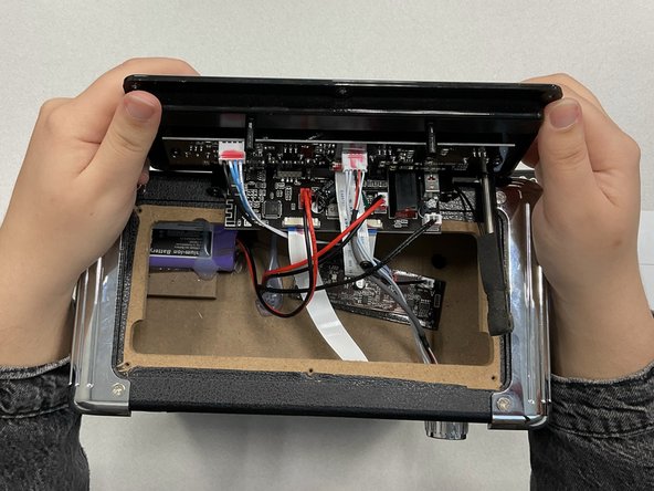

    • Remove the six screws around the perimeter of the top panel of the machine using a 2.5 mm flathead screwdriver.
  2. JYX-S55 Battery Replacement: crwdns2935265:02crwdnd2935265:01crwdnd2935265:01crwdne2935265:0
    • Grip the top panel with your thumb at the bottom and fingers around the top. Lift the panel until it comes loose.
  3. JYX-S55 Battery Replacement: crwdns2935265:03crwdnd2935265:01crwdnd2935265:02crwdne2935265:0 JYX-S55 Battery Replacement: crwdns2935265:03crwdnd2935265:02crwdnd2935265:02crwdne2935265:0
    • Move the top panel backwards and away from you. Let the panel hang down behind the machine, as this will allow you to have access to the components within the machine.
  4. JYX-S55 Battery Replacement: crwdns2935265:04crwdnd2935265:01crwdnd2935265:01crwdne2935265:0
    • Use a nylon spudger to pry the battery free from the glue.
    • It is important to note do NOT use heat or sharp objects, as the lithium-ion battery is flammable and could potentially explode.
  5. JYX-S55 Battery Replacement: crwdns2935265:05crwdnd2935265:01crwdnd2935265:01crwdne2935265:0
    • Disconnect the red and black wires from the battery.
    • Remove the battery from the device.

Hi, thanks for the pictures that really helped. What type of battery is needed? Can you email me at vrhaiza@gmail.com.
Rhaiza Villafranca - crwdns2934203:0crwdne2934203:0
Can you please advise what type of battery would be needed? What if I don't have a nylon spudger? What can I use in exchange?
Jasmine - crwdns2934203:0crwdne2934203:0
I opened the Karaoke machine:
Lithium-ion
Type- Lithium-ion Battery
Capacity: 3.7V/5200mAh
Model:18650C
Charging limited:4.2V
Date: 2022L1
