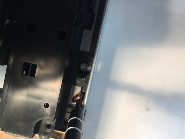

    • Using your Phillips Head Screwdriver, remove the four screws with the red markup.
    • Then, remove the three orange screws using your screwdriver.

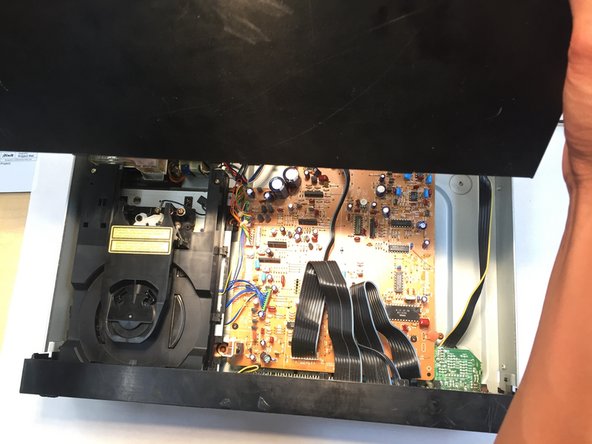

  2. JVC XL-333 Power Button Replacement: crwdns2935265:02crwdnd2935265:01crwdnd2935265:02crwdne2935265:0 JVC XL-333 Power Button Replacement: crwdns2935265:02crwdnd2935265:02crwdnd2935265:02crwdne2935265:0
    • Remove the two Phillips screws on both sides of the CD Player.
  3. JVC XL-333 Power Button Replacement: crwdns2935265:03crwdnd2935265:01crwdnd2935265:03crwdne2935265:0 JVC XL-333 Power Button Replacement: crwdns2935265:03crwdnd2935265:02crwdnd2935265:03crwdne2935265:0 JVC XL-333 Power Button Replacement: crwdns2935265:03crwdnd2935265:03crwdnd2935265:03crwdne2935265:0
    • Remove the top of the CD Player by holding each side of the roof then sliding it away from the front of the CD player.

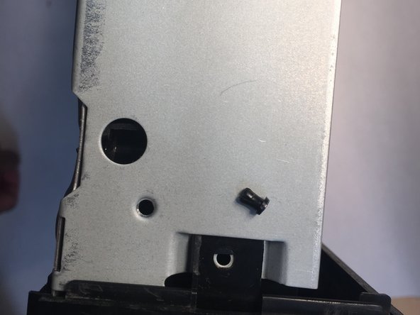

  4. JVC XL-333 Power Button Replacement: crwdns2935265:04crwdnd2935265:01crwdnd2935265:03crwdne2935265:0 JVC XL-333 Power Button Replacement: crwdns2935265:04crwdnd2935265:02crwdnd2935265:03crwdne2935265:0 JVC XL-333 Power Button Replacement: crwdns2935265:04crwdnd2935265:03crwdnd2935265:03crwdne2935265:0

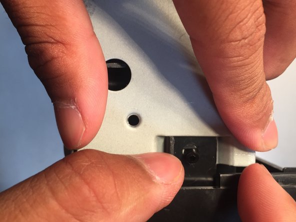

    • The disk reader is located above the power button.
    • Push out these tabs on both sides of the disk reader.

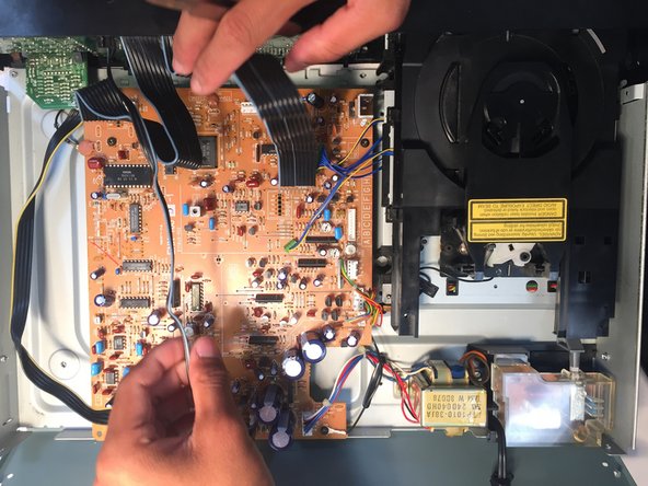

  5. JVC XL-333 Power Button Replacement: crwdns2935265:05crwdnd2935265:01crwdnd2935265:03crwdne2935265:0 JVC XL-333 Power Button Replacement: crwdns2935265:05crwdnd2935265:02crwdnd2935265:03crwdne2935265:0 JVC XL-333 Power Button Replacement: crwdns2935265:05crwdnd2935265:03crwdnd2935265:03crwdne2935265:0
    • Unscrew the four Phillips copper screws located at the four corners of the disc reader.
    • After the screws are removed, gently pull the disc reader up and out of the CD player.

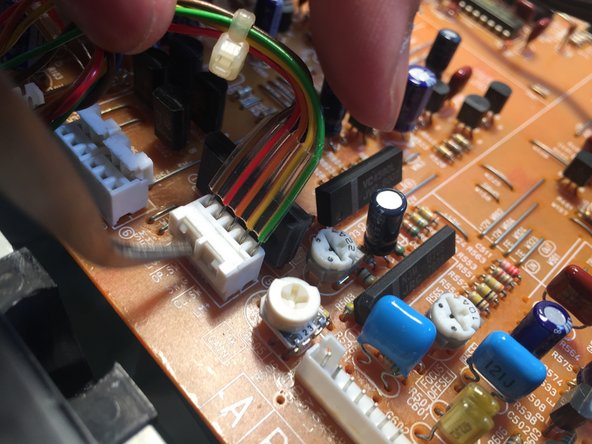

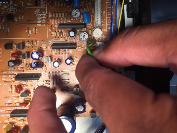

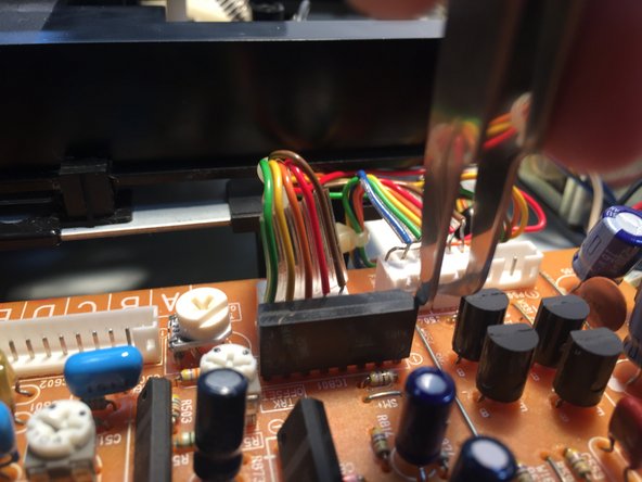

  6. JVC XL-333 Power Button Replacement: crwdns2935265:06crwdnd2935265:01crwdnd2935265:03crwdne2935265:0 JVC XL-333 Power Button Replacement: crwdns2935265:06crwdnd2935265:02crwdnd2935265:03crwdne2935265:0 JVC XL-333 Power Button Replacement: crwdns2935265:06crwdnd2935265:03crwdnd2935265:03crwdne2935265:0
    • Gently pull up to remove the two bunches of wires with a green connector from the motherboard.
    • Remove the two groups of wires with a white connector by using your spudger or tweezers to pull up on the side of the connector, opposite of the wires. It may require some force

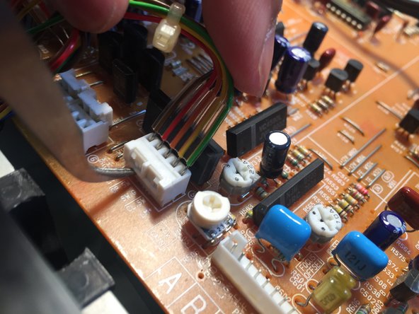

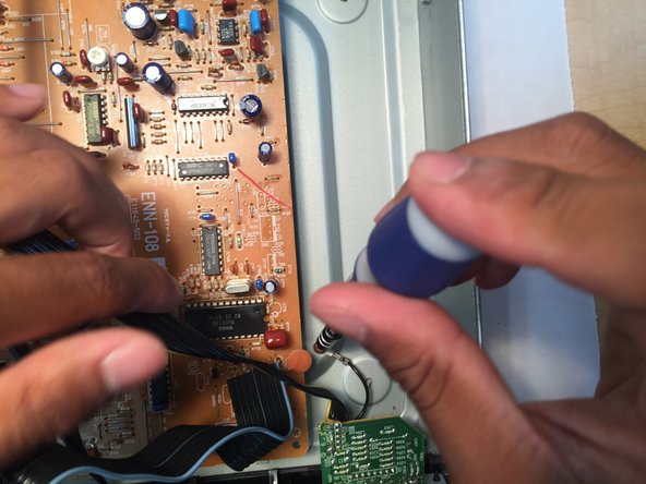

  7. JVC XL-333 Power Button Replacement: crwdns2935265:07crwdnd2935265:01crwdnd2935265:03crwdne2935265:0 JVC XL-333 Power Button Replacement: crwdns2935265:07crwdnd2935265:02crwdnd2935265:03crwdne2935265:0 JVC XL-333 Power Button Replacement: crwdns2935265:07crwdnd2935265:03crwdnd2935265:03crwdne2935265:0
    • These pictures offer other tricks and guidance on how to remove the wire connectors.
    • move your spudger or tweezer in an upward motion to release the wires.

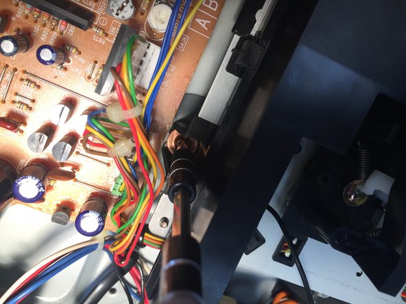

  8. JVC XL-333 Power Button Replacement: crwdns2935265:08crwdnd2935265:01crwdnd2935265:03crwdne2935265:0 JVC XL-333 Power Button Replacement: crwdns2935265:08crwdnd2935265:02crwdnd2935265:03crwdne2935265:0 JVC XL-333 Power Button Replacement: crwdns2935265:08crwdnd2935265:03crwdnd2935265:03crwdne2935265:0
    • Remove the rest of the wires connecting the motherboard to the CD player with your spudger or tweezers.
    • Remove the screw that connects the wire to the motherboard.

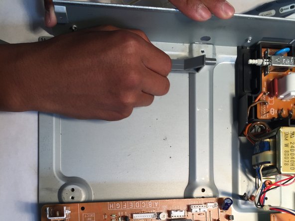

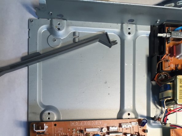

  9. JVC XL-333 Power Button Replacement: crwdns2935265:09crwdnd2935265:01crwdnd2935265:03crwdne2935265:0 JVC XL-333 Power Button Replacement: crwdns2935265:09crwdnd2935265:02crwdnd2935265:03crwdne2935265:0 JVC XL-333 Power Button Replacement: crwdns2935265:09crwdnd2935265:03crwdnd2935265:03crwdne2935265:0
    • Find the power button trigger on the left side of the CD Player. It should be gray.
    • Push it a couple times to make sure it works. If not hold it 3/4 of the way and pull with some force.
    • Replace with a new one.
    • Replace the motherboard, reattach the cables and repeat the rest of the previous tasks in reverse.
