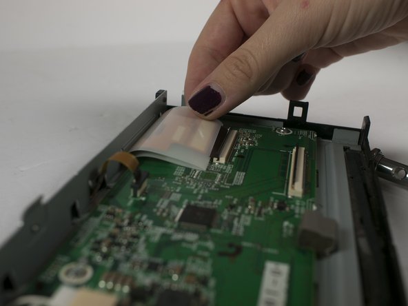

  5. JVC KW-V820BT Touch Screen Replacement: crwdns2935265:05crwdnd2935265:01crwdnd2935265:03crwdne2935265:0 JVC KW-V820BT Touch Screen Replacement: crwdns2935265:05crwdnd2935265:02crwdnd2935265:03crwdne2935265:0 JVC KW-V820BT Touch Screen Replacement: crwdns2935265:05crwdnd2935265:03crwdnd2935265:03crwdne2935265:0
    • Gently separate the ribbon cable from from ZIF connector on the circuit board using a metal smudger.
    • Be careful not to scratch or damage components or features of the circuit board with the metal spudger

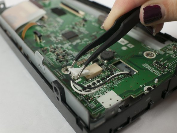

  6. JVC KW-V820BT Touch Screen Replacement, Touch Screen: crwdns2935265:06crwdnd2935265:01crwdnd2935265:03crwdne2935265:0 JVC KW-V820BT Touch Screen Replacement, Touch Screen: crwdns2935265:06crwdnd2935265:02crwdnd2935265:03crwdne2935265:0 JVC KW-V820BT Touch Screen Replacement, Touch Screen: crwdns2935265:06crwdnd2935265:03crwdnd2935265:03crwdne2935265:0
    • Remove the power connector gently using tweezers or your fingers.
    • Remove the ribbon cable ZIF connector by flipping the black plastic bar and sliding the ribbon out.

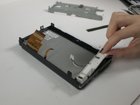

  8. JVC KW-V820BT Touch Screen Replacement: crwdns2935265:08crwdnd2935265:01crwdnd2935265:03crwdne2935265:0 JVC KW-V820BT Touch Screen Replacement: crwdns2935265:08crwdnd2935265:02crwdnd2935265:03crwdne2935265:0 JVC KW-V820BT Touch Screen Replacement: crwdns2935265:08crwdnd2935265:03crwdnd2935265:03crwdne2935265:0
    • Remove the metal retaining shroud.
    • Remove the fabric disk drive passage liner.
    • Remove the white plastic button retainer.

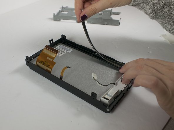

  9. JVC KW-V820BT Touch Screen Replacement: crwdns2935265:09crwdnd2935265:01crwdnd2935265:03crwdne2935265:0 JVC KW-V820BT Touch Screen Replacement: crwdns2935265:09crwdnd2935265:02crwdnd2935265:03crwdne2935265:0 JVC KW-V820BT Touch Screen Replacement: crwdns2935265:09crwdnd2935265:03crwdnd2935265:03crwdne2935265:0
    • Remove LCD display.
    • Remove touch-activated side button display.
    • Remove global touch screen assembly.
    • Be careful when handling glass, especially broke glass. It is suggested to wear cut-resistant gloves when handling glass.

Hi Arturo, without looking at the device, I can only guess. But, if it doesn’t respond to any touch whatsoever, you might take a second look at the touchscreen component itself (that is the clear glass sheet, step 9, picture 3) and be sure you have that thing connected properly and there is no damage to that little ribbon cable itself. I’m not aware of any calibration procedure, but I could be wrong.
